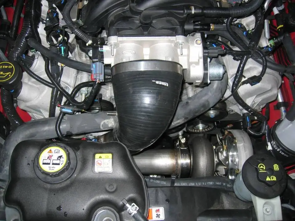

Which turbocharger
So if I am going turbo I have decided on the THP
67mm Ball bearing
60# injectors
upgraded intercooler
44mm waste gate
I can get it for around 5900.
Good deal? Also does anyone know anything about THPs fuel system they supply?
I'm either going with this or a PD blower, but I'm pretty sure I have to have the turbo.
Comments? Suggestions?
Call them, but I think it comes with a GT500 dual pump kit which is plenty (good to probably over 600rwhp with dual Boost-a-pumps and probably close to 600rwhp w/out BAPs). I highly recommend THP as a good friend has their kit and is building a motor and shooting for close to 1,000rwhp with their kit and a 76mm turbo (obviously with a more robust fuel system)
