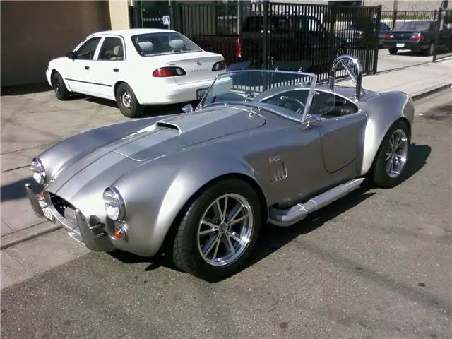

In the mean time how about a pic of the FFR that the mustang will share the garage with.
