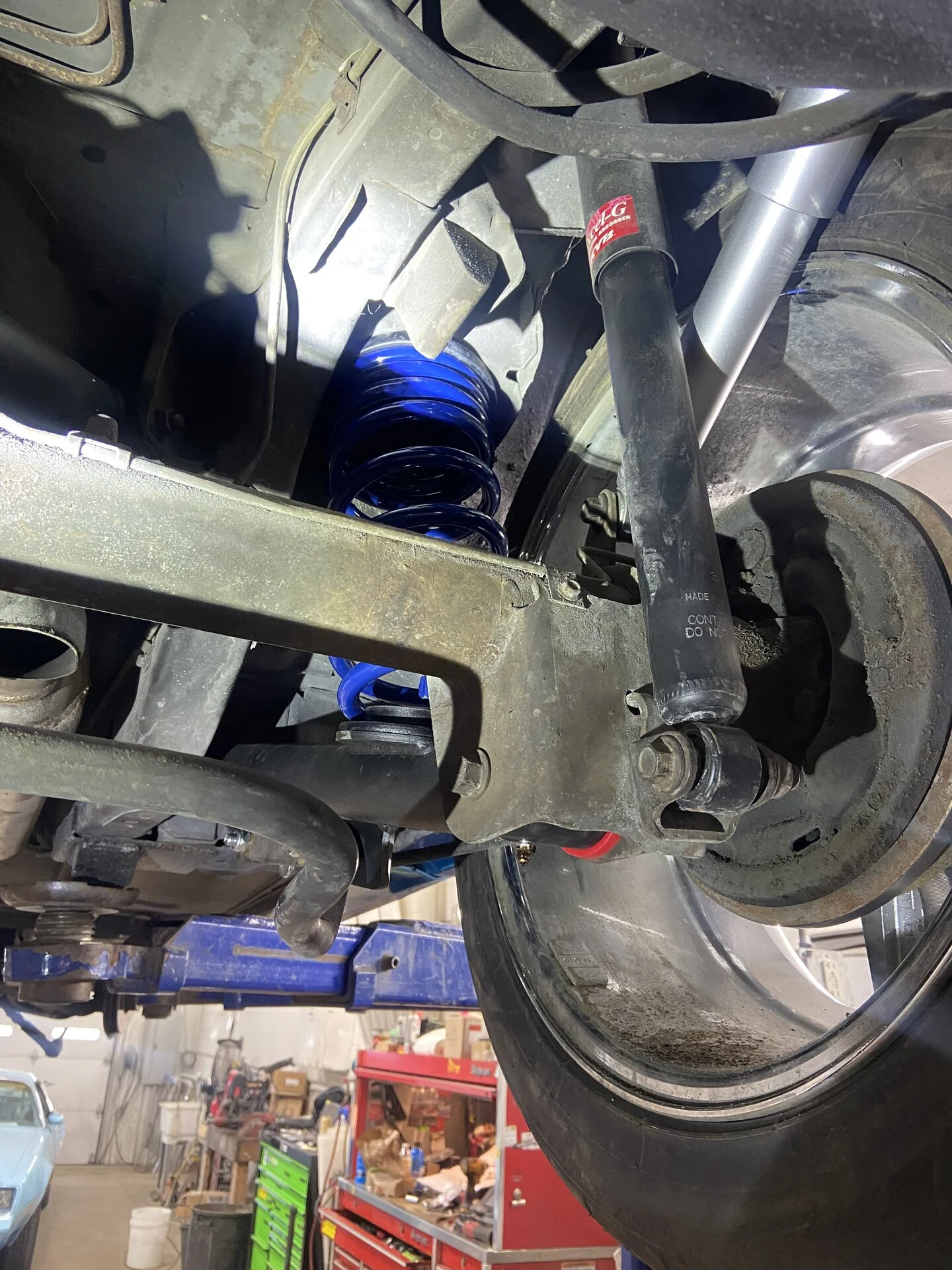

This is my current set up with a 245/45/17 want to switch to a 275/40/17 in the rear but even if I flip the quad shock I don’t think there is any way I can get a 275 on with out rubbing. Any and all comments appreciated.
I have 275's on 9" wide 17" ponies and they fit fine without doing anything to the quad shock, but I have the factory quad shocks and they look smaller than the ones you have.

You are using the wrong quad shocks.
Use stock ones or stock style.

I do have maximum motor sport upper and lower rear control arms with steeda springs which are all new. I did order a set of factory style Gabriel quad which but I’m not sure it’s that beneficial.

Why are you running the quads anyway? Looks like you have a nice lower control arm.
I ran without quads for years and always had wheel hop. Max Motorsports lowers, brand new rubber upper control arms. Different combinations of springs, shocks and tires. I checked the pinion angle and it was spot on, but always had hop. I've always run good sticky tires.
Finally I just ended up putting them back on and they do the job.

I’m running 17” 275 with no tire rub. Brand new Gabriel’s flipped, but I notice what seems to be the quad rubbing against the main shock.
I’m thinking of just removing the quad(running MM control arms), or maybe removing the dust shield like suggested may do the trick! I’ll have to think about it.

However, I am doing it on a 95 GT Convertible. Also, you appear to have KYB replacements. The Gabriels do not have the upper tube, which is the part rubbing.
