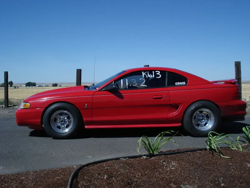

I run 28" tires on my car front and rear at the track. They might be a little tight out back but they should work ok. I think they are definitely more tire than you need, but they will fit.
