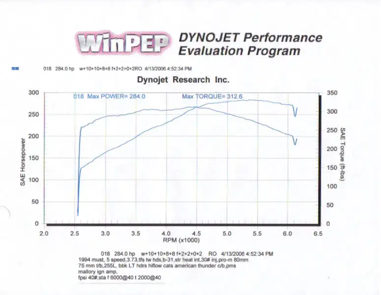

what kind of power are you making with them?
GRGT1994
Sep 22, 2004
1,034
May 18, 2007
#11
  • May 18, 2007
  • #11
Here's what Anderson Ford Motorsport tuned mine to.
See my sig for mods. I dont think I added to my sig the fuel pressure regulator, PMS, or ignition upgrade that AFM did for me yet.
