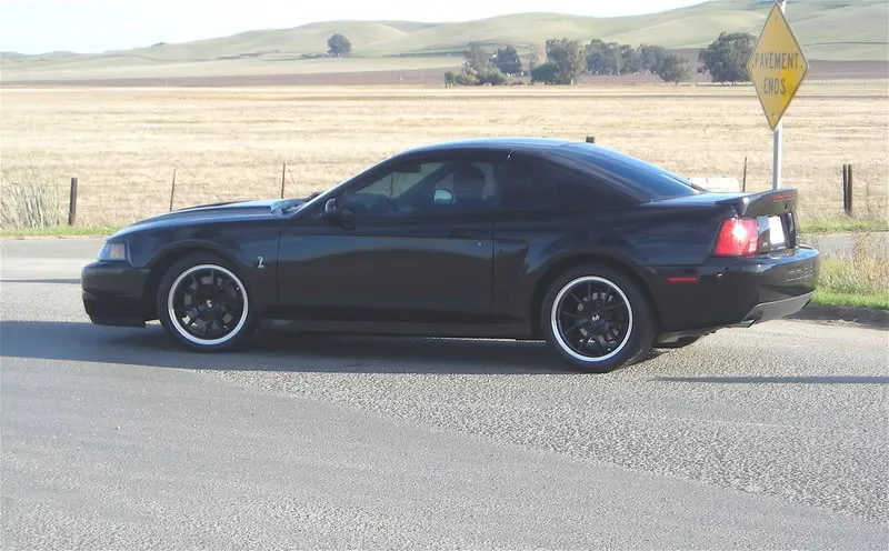

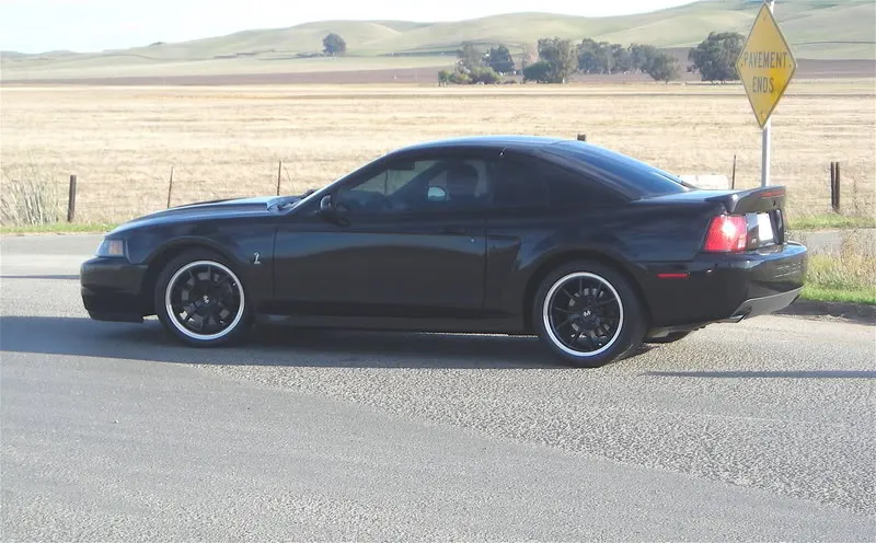

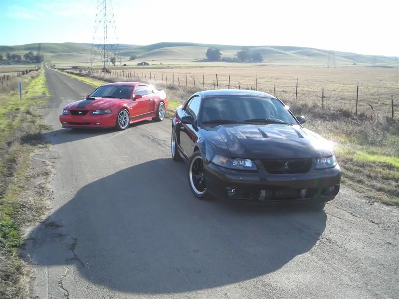

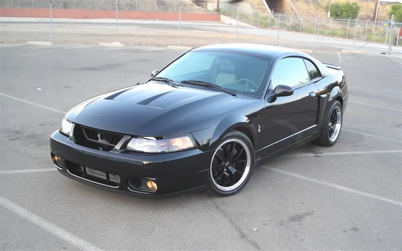

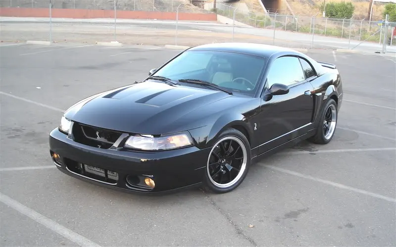

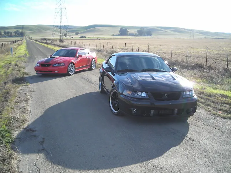

this is my buddies 03 Cobra:drool: & my 03 mach in the back....
