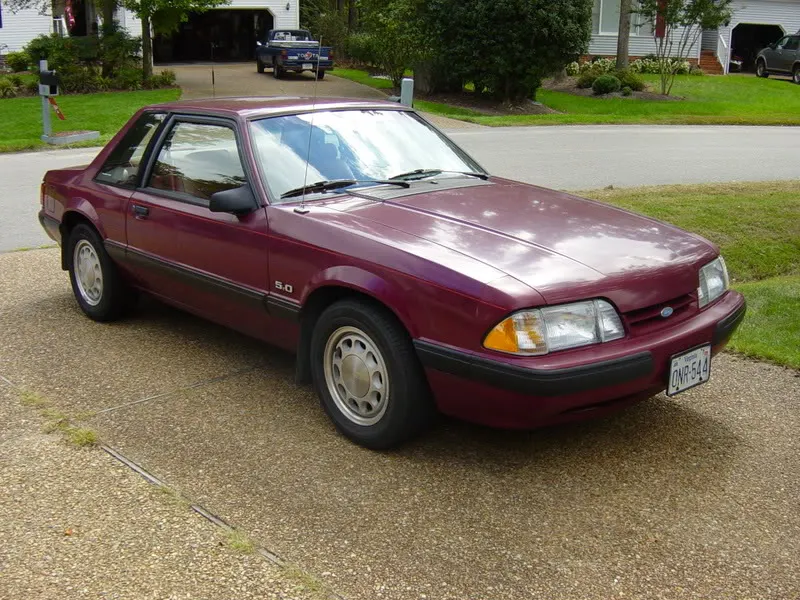

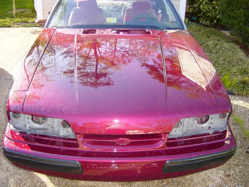

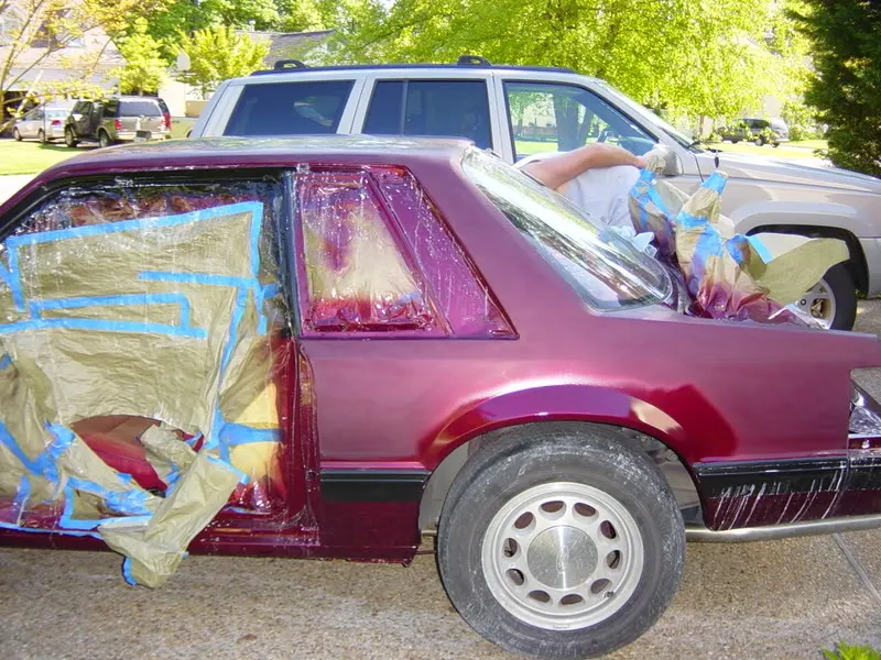

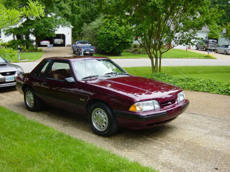

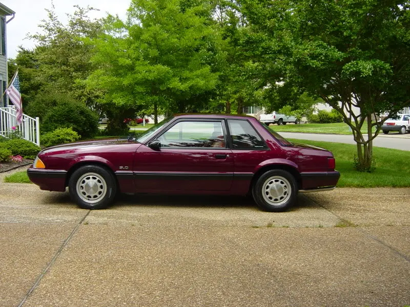

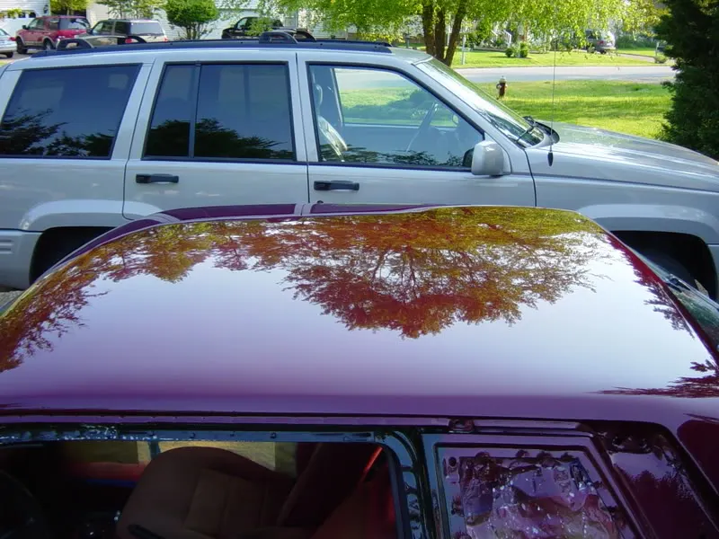

Here's some pics from the last car I did in our garage.
The before shot of our 87' LX 5.0, with faded original paint.
Here's what the 'paint booth' (the garage) looked like. The compressor is always outside while painting.
The front end
The roof

A few final shots
I'm a big believer in what others have said, power tools only for stripping the paint, and all sanding should be done by hand using blocks or board sanders. This is the first car I've ever painted in a garage this small, but it goes to show that it can be done. Patience is the most important thing when it comes to bodywork and painting. Shortcuts never work.
