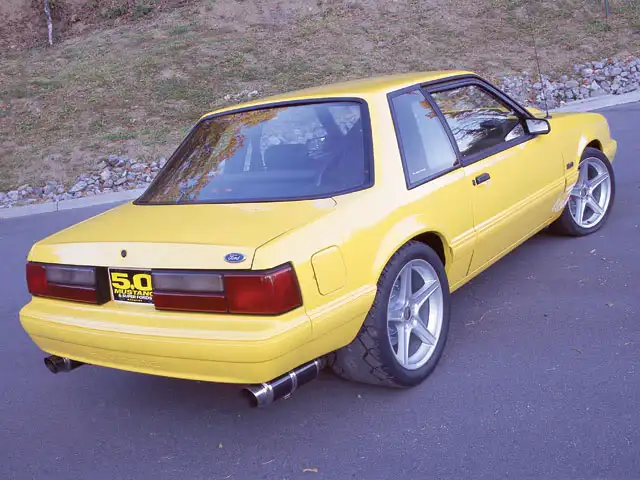

This is the car i think of every time someone says mini tub. I don't remember the width but those are 18s in the back and they're enormous. The mufflers are really really stupid, but with a 731hp turbo 5.4, you can do that if you want.
[/IMG]
I don't make 731 HP but I do make more torque and power than I can put to the ground. A nice wide, fat, soft DR would be sweet!
--until the 5 spd is twisted into something resembling a prezel.
