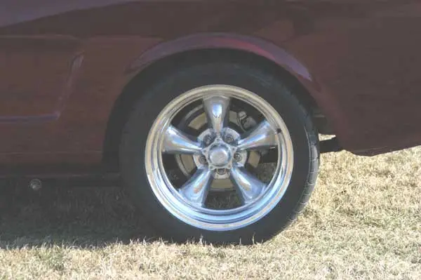

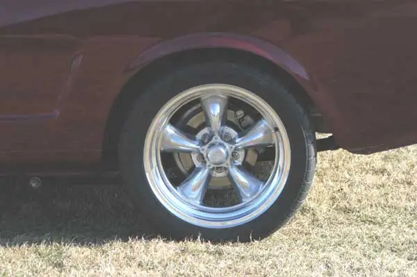

SSBC with 13 and 11 inch rotors.

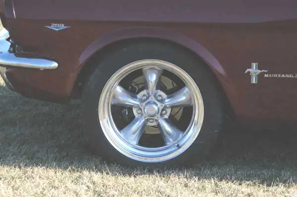

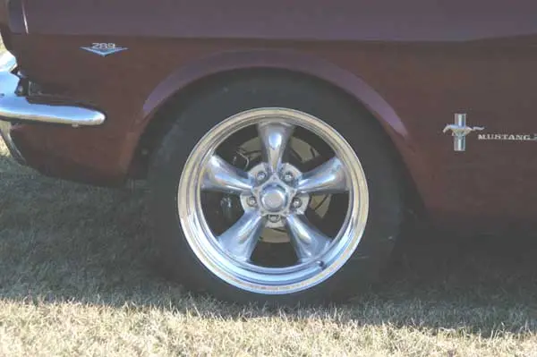

Baer (image courtesy of Jay):
