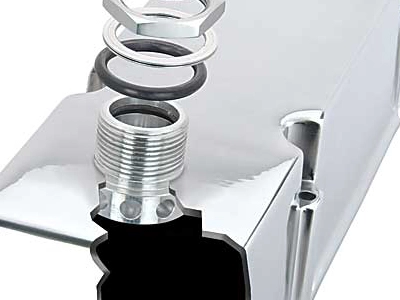

Bought some Ford Racing finned aluminum valve covers from Summit. Just wondering why they bother including a breather cap if it's not the right one?
Anyone else notice this? I thought I saw a thread about this a while ago, but couldn't find it. I know Summit didn't give me the wrong part.
Edit:
To clarify. The valve covers have a breather tube. But the cap is a push-in. With a grommet it works, but looks like crap. Wouldn't a push-on cap without a grommet have been better? :shrug:
The cap on the top valve cover in this pic is similar to what it ends up looking like.:shrug:
That's right. Push-in for grommets, push-on for tubes. Aftermarket companies such as Moroso, Mr. Gasket, and Trans-Dapt should sell a push-ON style or even a K&N clamp on style should work. Maybe it's me, but that tube looks too long.

That pic isn't my set, but just an example. Without measuring I'd guess the tube is only about .5" longer than stock. NPD has a seperate tube that looks identical if you want to add one to aftermarket covers. The description says it's for emmission equiped 289's.:shrug:
