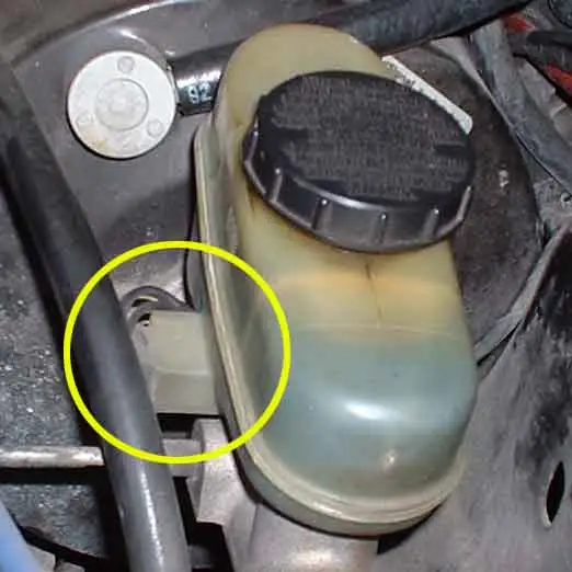

Here's a pic for ya.
There is a magnet attached to the float in the fluid reservoir that triggers this switch (it's a reed switch). When the fluid is low, the float goes down, and the magnet is closer to the switch. When it gets close enough, it triggers the switch. If this switch is 'on', it could be bad, the fluid could be low, the float could be stuck down, or the magnet (normally attached to the float) could have come off the float, and is lying at the bottom of the reservoir.
Another cause is ignition wires near the switch. Ignition wires can't be within a 2" radius of the switch assy. I would GUESS that this MIGHT be a problem if you have a MSD mounted on the firewall near the brake booster. That seems to be the most common place to mount the MSD.
Rick
