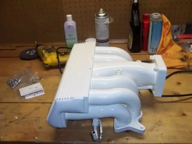

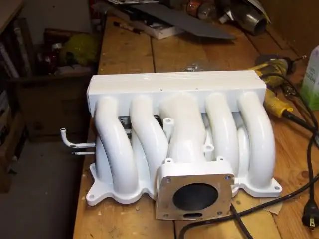

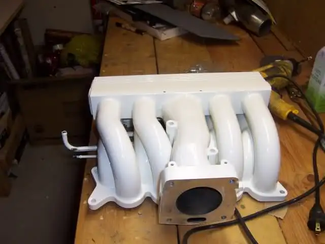

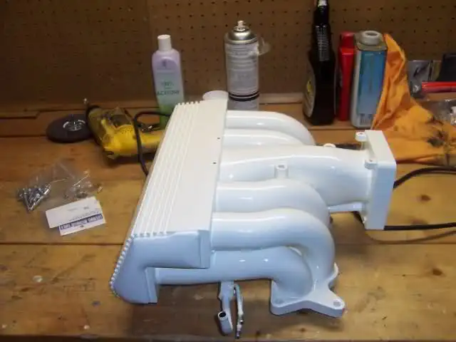

I think the Cobra intake is an awesome street car intake as well. I have an original one of a '93 cobra that i just powdercoated and put a new sticker on so it looks better then new now lol. But i'll be putting out 400rwhp through it this spring when the car gets tuned. I also think it is the best looking intake besides the Systemax II. :nice:
