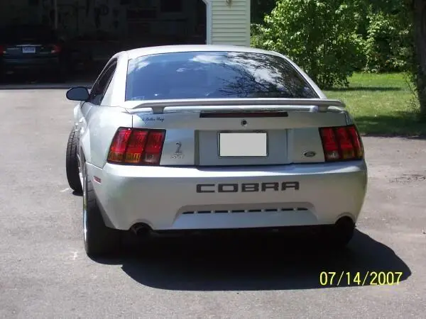

You hit the nail on the head. I purchased the ones in the thread and found the center hole that went over my hubcentric hub was about .002 to small and that metal had to be removed before I could use them. It was a small enough amount that I could remove it with emery cloth but you'd be surprised how hard aluminium can be.
Other than that, I'm happy with them and they look great. A retorque after a thousand miles is recommended and necessary. Here's a pic before the H&R Sports.
