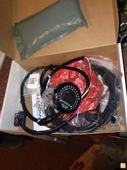

I am a bit of an inconspicuous person . I want to keep the interior as factory as possible but still have this thing where I can see it any ideas guys ? it's 2 1/16 innovative mtx-l

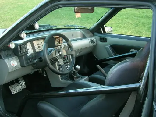

? I like races thread where he put his plx but then what about the hazards ? Not worried about the defroster because when the window was tinted the lines had to be scraped
Jeff i would put it somewhere you can see it thats for sure i use that gauge more then any of my others to make sure its not leaning out...Im guessing you dont want to use a pillar pod?...thats what i have boost and AF gauge...put it in the vent above the radio and heater controls? Our cars dont really have that many good hiding places...lol

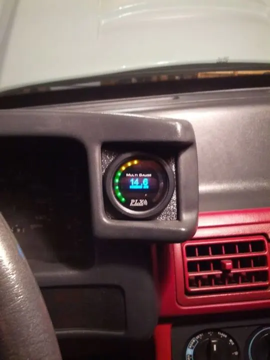

Here's mine
I used a 1/8" thick piece of textured abs stock off ebay and trimmed it to fit the opening. It matches almost perfectly, the camera flash creates that shine effect. Its very snug, but can be removed if needed. For the hazard switch, I zip tied it up underneath the dash. It can be reached easily if needed. It must remain plugged in for the rest of the lughts to function properly.

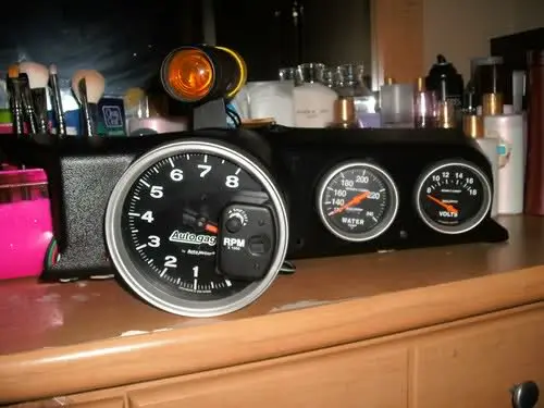

I have seen pods like this one:
for 87-93 that DO NOT have the big opening for a tach. Just 3 or 4 of the smaller openings for actual gauges. If you can find one of those, you're in!
