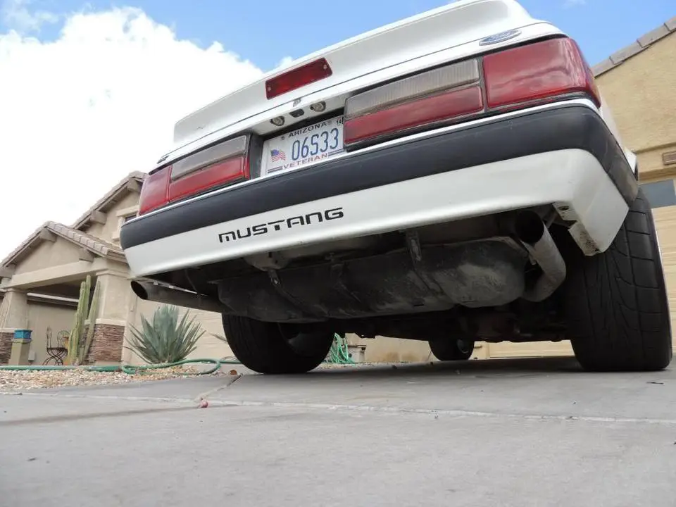

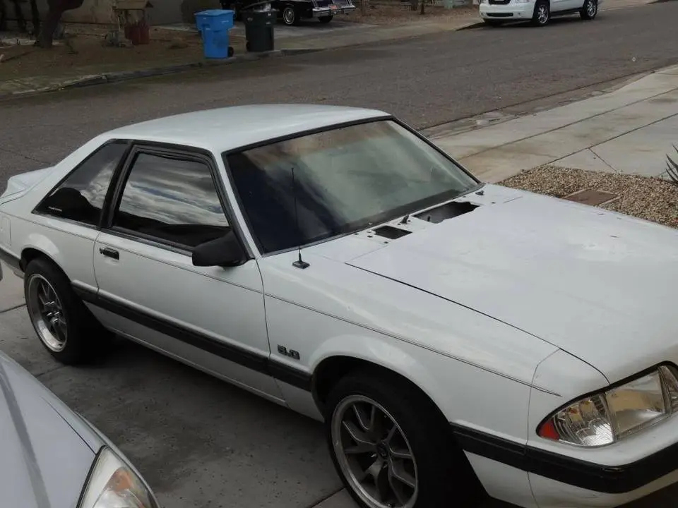

Here is a pic of my setup. The rear is narrowed 1/4"
pic.php
pic.php
They tuck in really nice with that setup. The 275/60 drag radials fit even better cause they run a little smaller.
