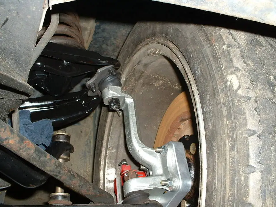

I would like to use the new v6 16s myself(I dont want any 17s because I think they are just too big and dont offer any advantage) where do the 16s rub on the ball joint? I would think that with 1 1/2" spacers the spokes at least would clear...is it the lip? I would actually only have to use spacers on the front on mine(I use a 84 lincoln 8.8" out back which just happens to be 1 1/2" wider on each side(or damn close to it anyway) anyway I guess my real question is whether there is anything I could do to solve the wheel rub problem because I have been wanting to use those wheels for awhile now and I'm sure they dont make any with the correct backspacing in 16" sizes
What I think you will find with the 16" rims is that they will want to rub at the ball joint area on the upper control arms. This is why most people use the 17" rims it affords more room for the upper control arm. Here's a picture of 17x8's on the front of a 70.

would a shelby drop help this? its a modification i was planning on doing anyway...and if it dropped the UCA....presumably it should also drop the ball joint area slightly correct? or would it just tip the ball joint area upward more? not being a suspension expert here I dont know....I have another question though...obviously wheels smaller than 17s fit classic mustangs...how do the stock wheels(and aftermarket wheels in the range of 15-16" avoid this issue?
I'm not sure of the answers to all your questions. The picture I posted has the shelby 1" drop done to the car. The upper ball joint will stay in the same place, remember you are not changing the spindle assembly any which is where the ball joint is. Your just lowering the inner mounting point of the upper control arm.
