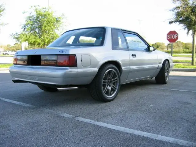

255's all the way around
9350coupe
May 11, 2005
109
chicago
Apr 17, 2008
#11
  • Apr 17, 2008
  • #11
255's all the way around............hmmm my pic did not post

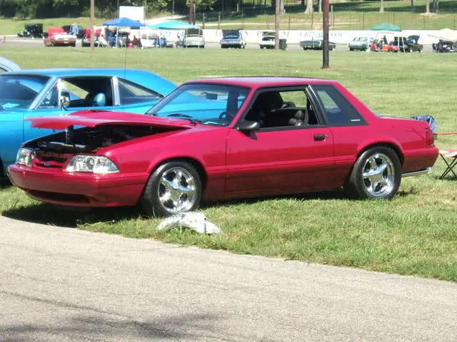

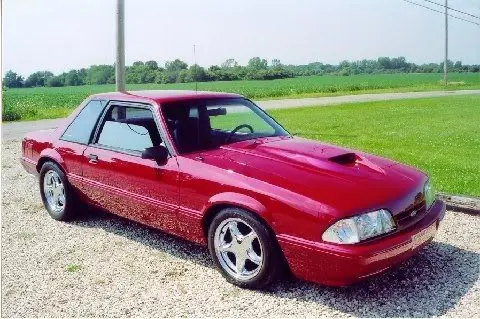

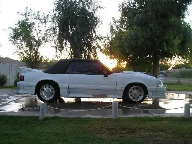

I have 245/50/16 and 225/50/16 they look good i think. no rubbing

BFG 225/50 and 255/50 Drag Radials
