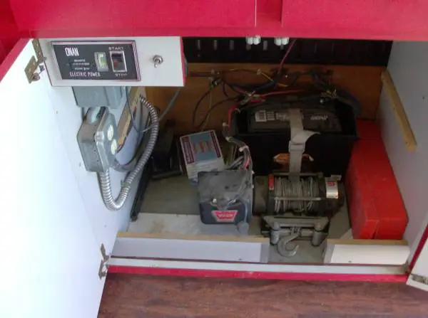

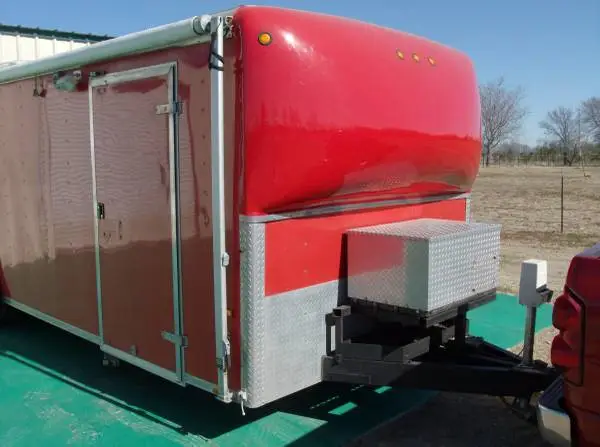

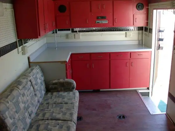

I'm getting a trailer. If things work out well, I'm going to buy this trailer, this weekend. It's a 1996 Wells Cargo. 7' wide, not sure how tall, 24' long. Comes with Generator, Winch, A/C, stereo, TV, interior/exterior lights, E-Trac walls, D-rings on the floor, a generator, mounted 110 plugs, exterior canopy, 6,500lbs dexter(?) axles, with a GVWR of 13k lbs, which is absolutely perfect for the tow rating of my new-old truck.

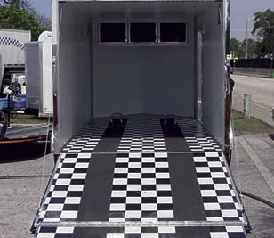

My biggest concern is that it's a 7' trailer, not an 8.5 like most car haulers. The guy says he hauled his '67 Camaro in it for years. The dimensions of the foxbody are apparently just under 6' wide. I know I'm not opening any doors, but I'll crawl out of the hatch if I have to. So my question is: Can I get it onto the trailer?
