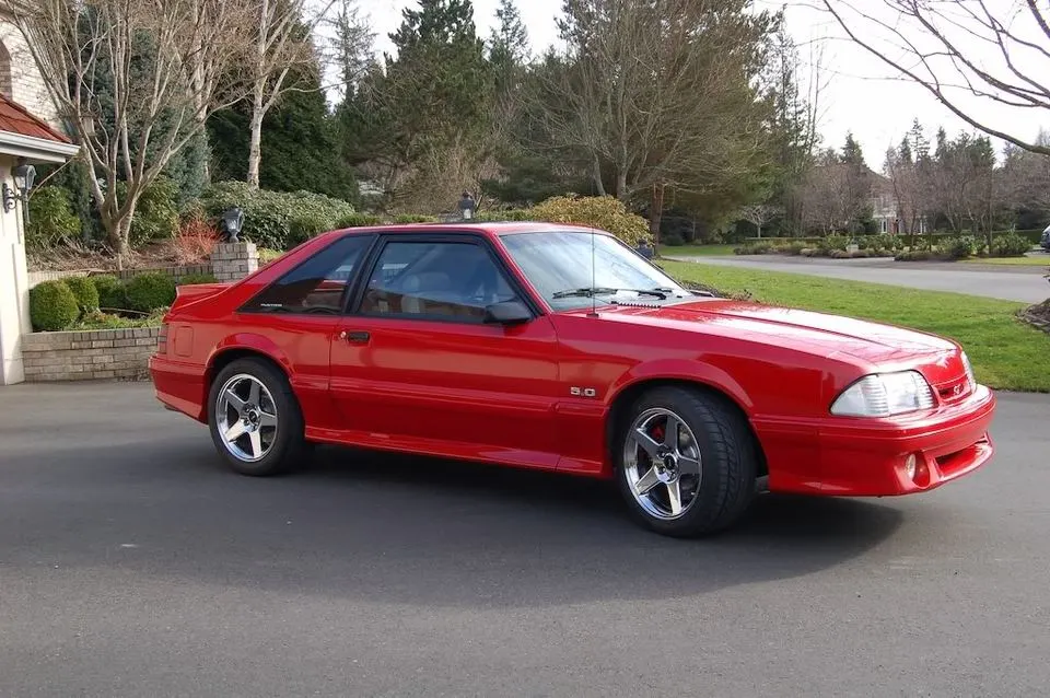

Here is a picture of a GT with Cobra GFX and rear bumper...

You may need slightly longer hangars on the tailpipes to clear the bumper. It will depend on the system. I'd recommend a little bit of a gap to avoid warping the bumper. I've seen this happen when tailpipes are too physically close to the bumper and heat it up
