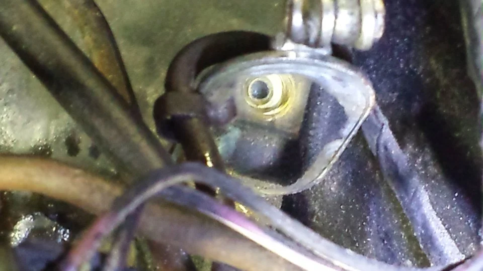

Ahhhh. Okay. The switch is out and you're looking at a pic through my mirror. This is down the switch port. The switch pushrod moves when I push it with my finger.
Do you see anything odd? I just don't know the difference between what I'm supposed to be looking for and what I see.

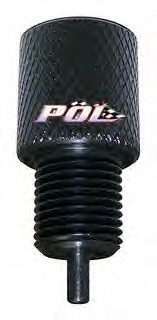

This is what the piston looks like , i could not find a pic of the tool .It is a thumb nut with a pin on the end ,it screws into the block through the sender opening and keeps the piston centered while bleeding the brakes .It is removed after bleeding and the sender is replaced .

I cant tell by the pic ,i see the piston but cant tell if it is centered .My last pic that shows the brass piston ,the one with the V in it .The V is where the light and the tool would be if it is centered .
I see what you're talking about. Since the information in the manual I have don't say nuttin bout no propotioning valve tool while bleeding...I would imagine this definitely is a possibility I need to focus on. I can't tell if the 'V' is centered or not without taking it all apart and seeing where the piston is situated.

It is just a small thumb nut ,been a while since i bought one but it was not much .Seems like i had a tough time locating one though .Do you have a shop that specializes in brakes ?There was a thread not long ago that showed the tool but i dont what the thread was called :shrug:

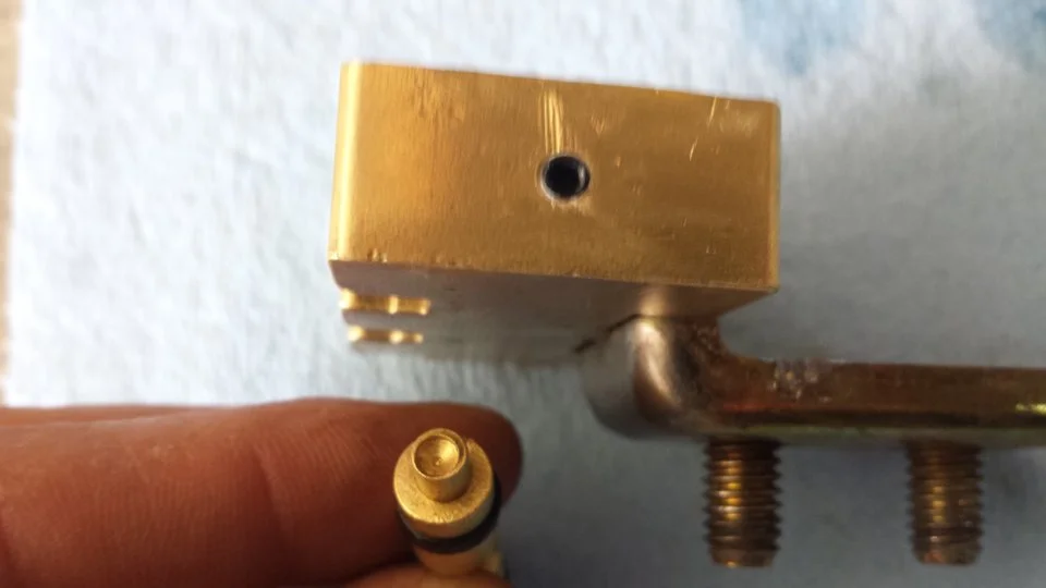

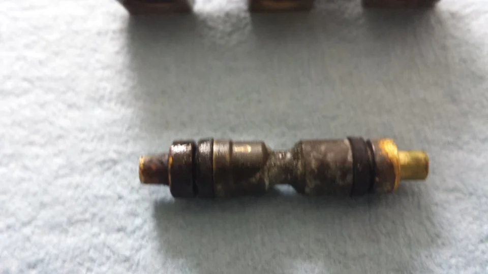

I had two problems. 1) The brake light (dash idiot) switch was so dirty it wasn't grounding. I cleaned it. Brake light stayed on. This was my clue the valve wasn't moving.
2) Valve wasn't sliding in the block housing. Took the block off. Valve was frozen. Drilled the body to punch it out (no other option). Cleaned it. Plugged it with an allen set-screw and thread sealer. Put it back together. Bled it. Dash brake light came on while bleeding. Followed shop manual to set and center the valve. Worked like a champ. Beautiful. No leaks. Bled the system. Still no brakes. WTF!?!? All 4 cylinders, master cylinder, distribution block, everything seems spot on...still have to kill the pedal to get it to stop. Any more ideas?
