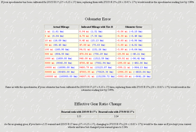

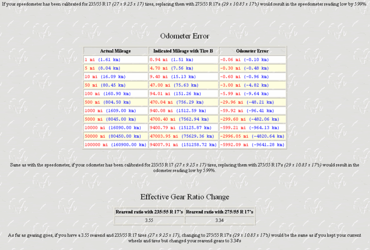

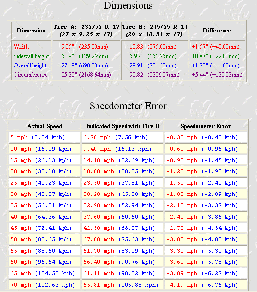

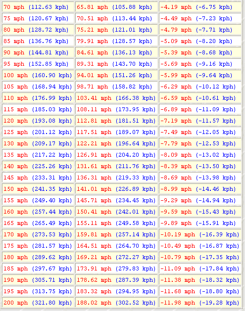

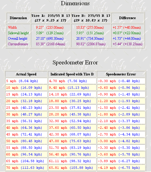

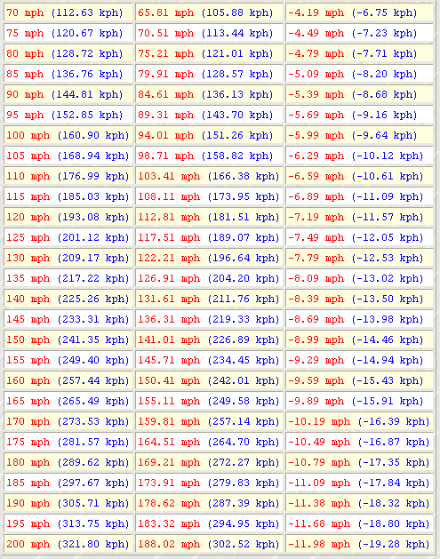

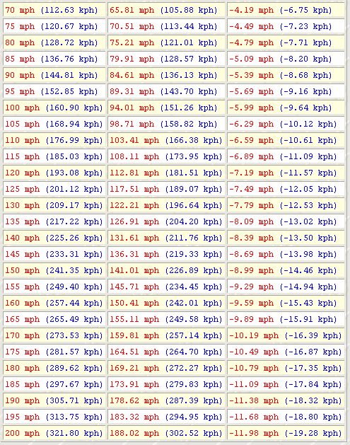

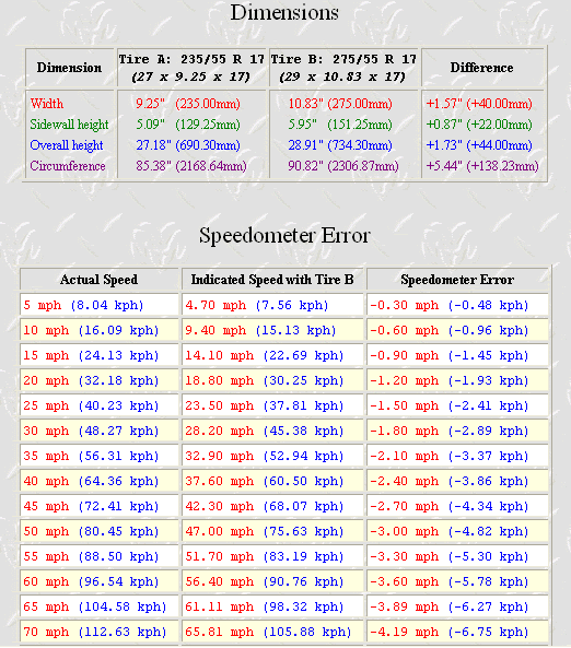

taller tires help top speed, but hurt take off speed. it changes your final drive ratio. it basically makes your gear ratio seem like a numerically lower ratio.

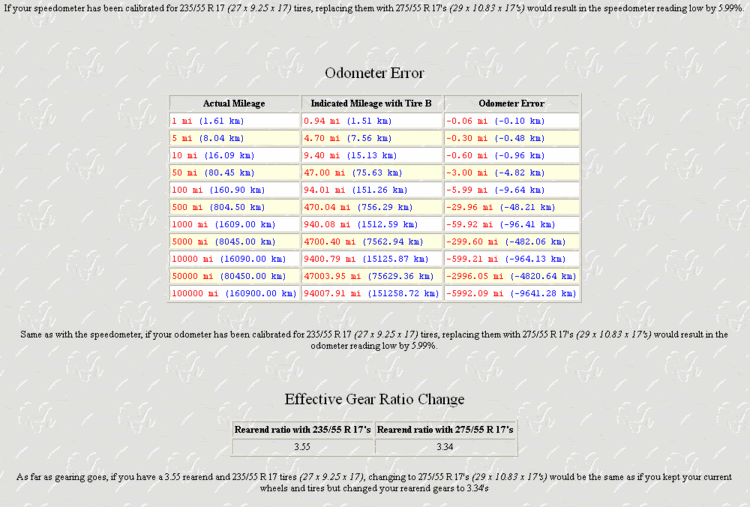

i assume that you had a 5 speed with 3.55s. basically if this is true, it would be about the same as using the stock wheels with 3.34 gear ratio. (standard 05/06 automatic and 07 ratio is 3.31) it would slow you down a little. the difference would be in the tenths, so not a huge deal unless you are trying to get the fastest ET possible. but you could fix that with a gear swap. :)
if you installed 4.30s, the effective ratio would be 4.04, very similar to stock heigt tires with 4.10s.
