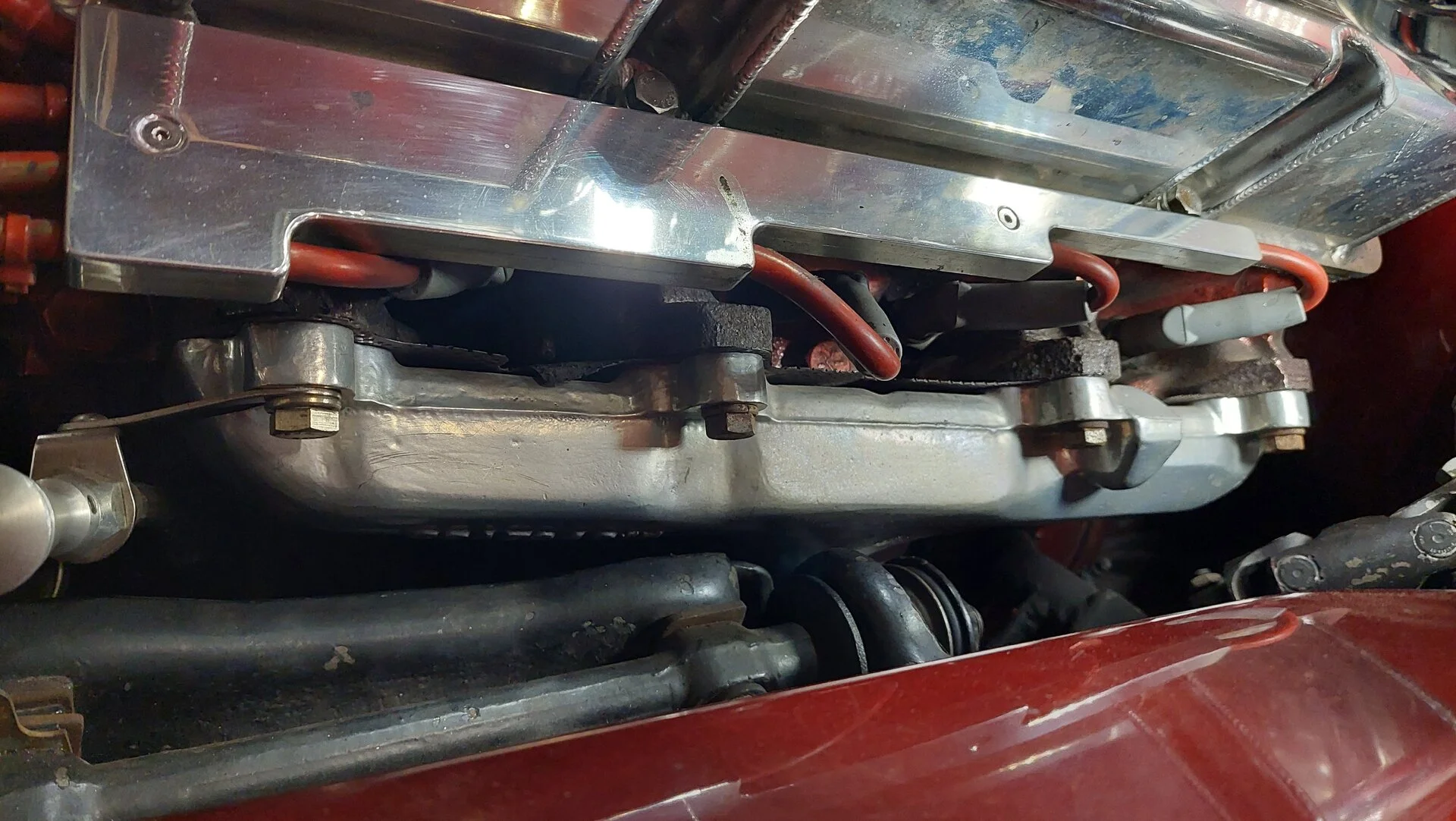

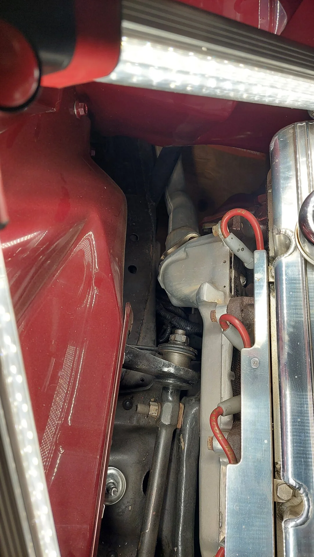

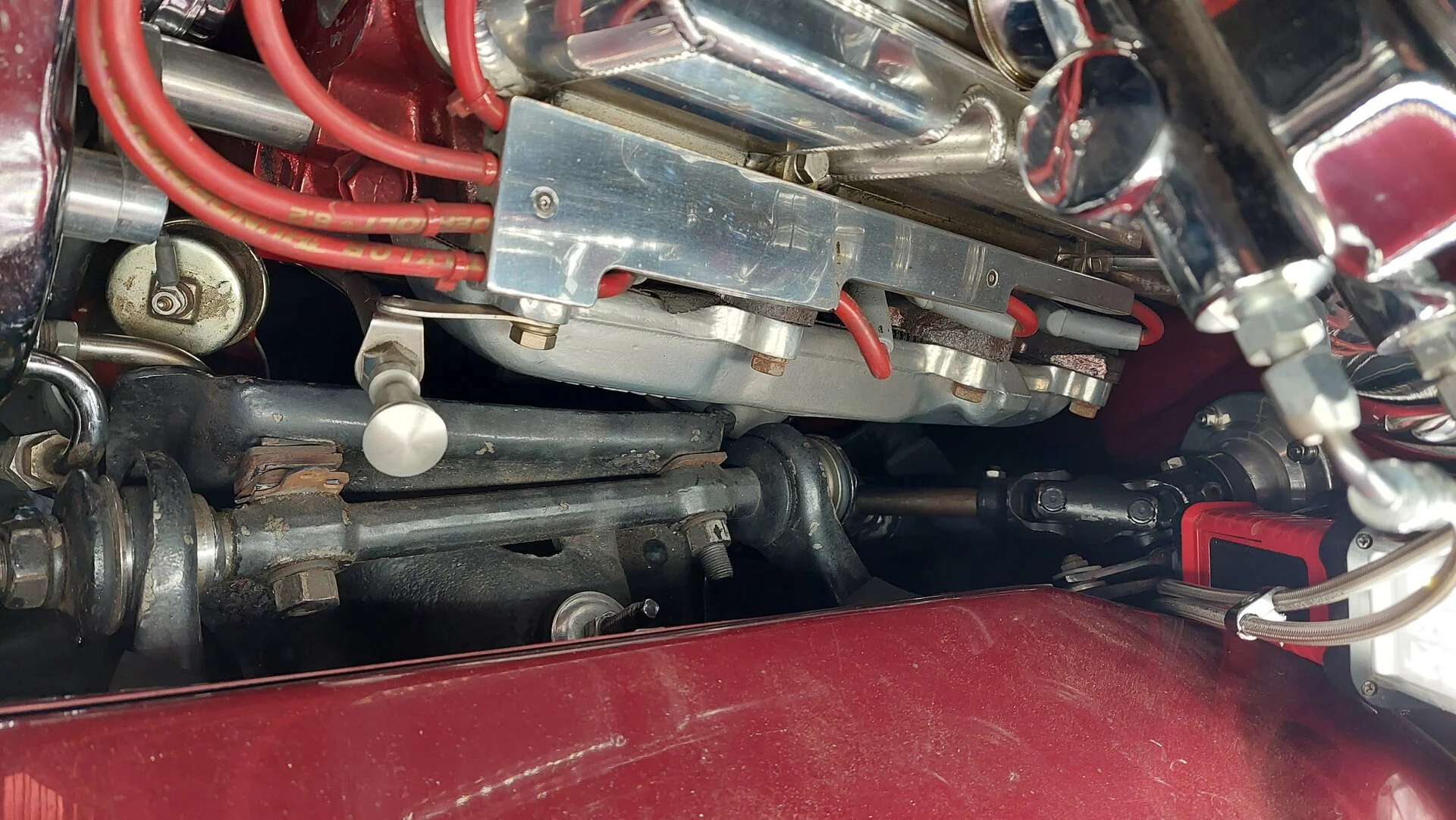

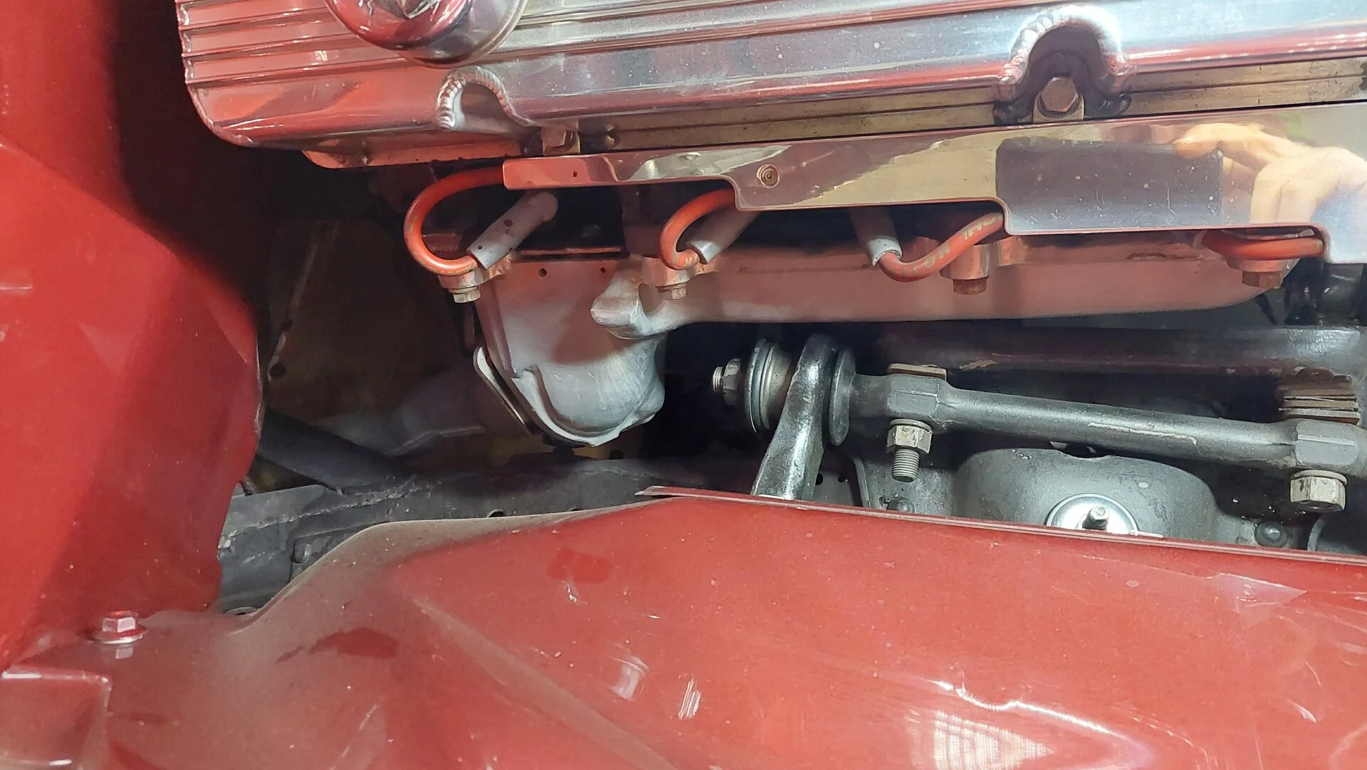

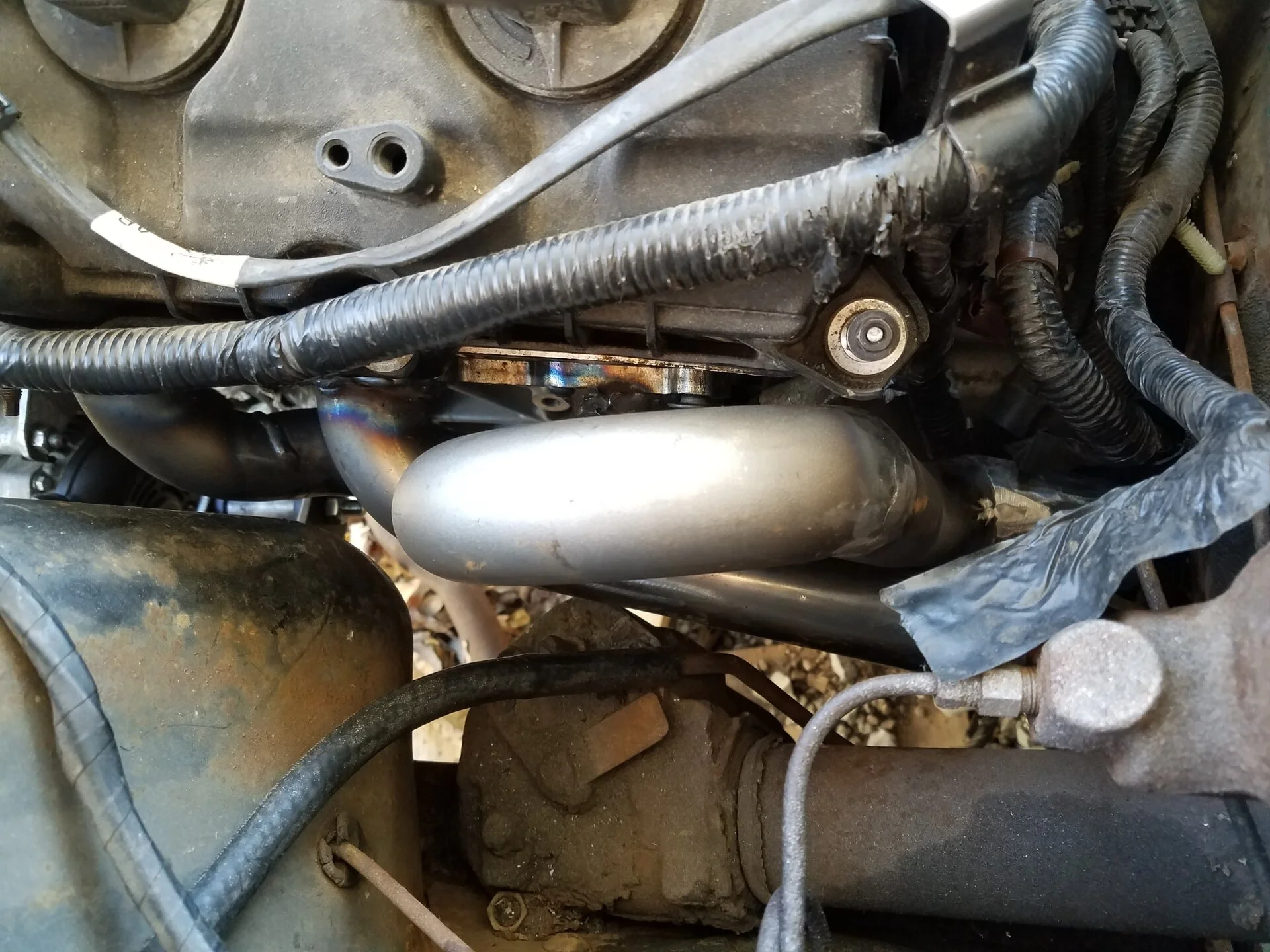

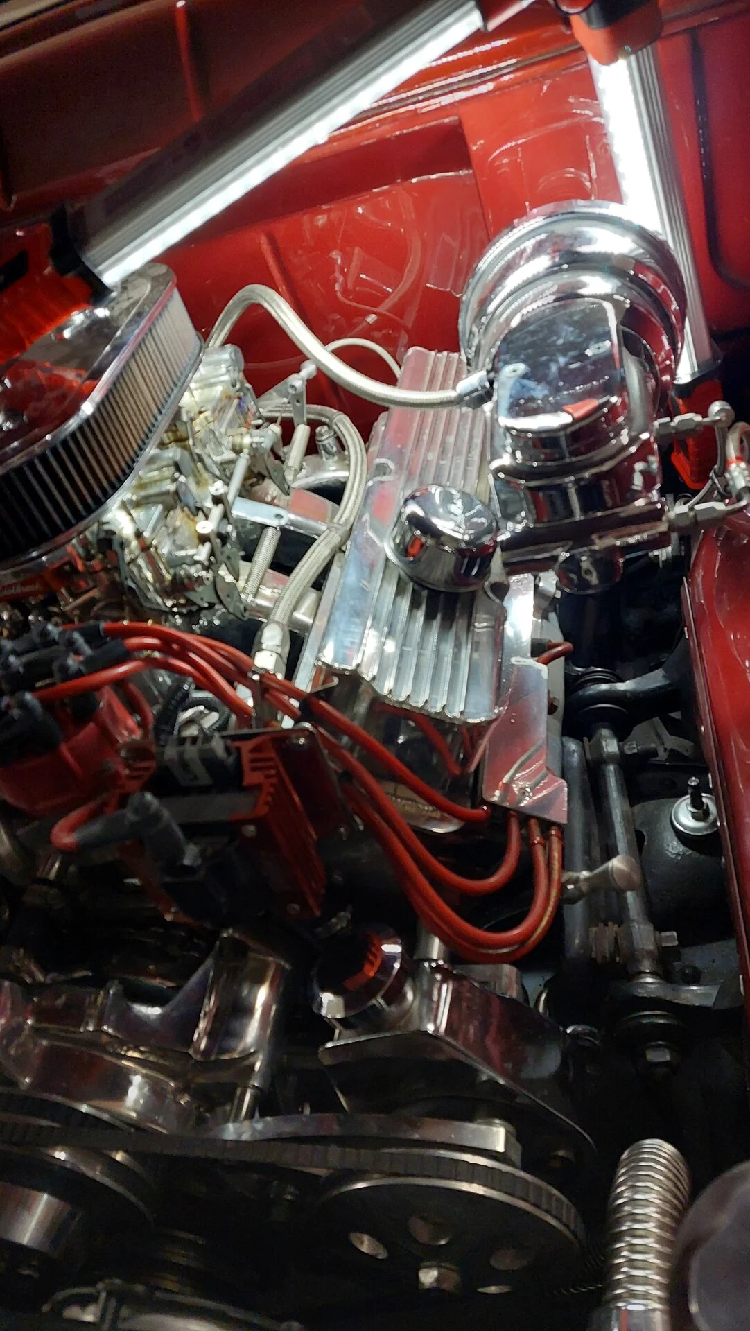

I don't believe for a second that there isn't room to add headers, as an example, I built headers for my engine and only had this much room to work with:
Most times shops just don't want to take on tight clearances when building headers, too many issues that come with it.

I agree that headers can be made for the vehicle
I have a 56 too with a 429 in it and Headers are next.
I agree there is not much room. I am going with custom made fenderwell exit headers

I just am finishing putting a Tremec 5 speed in (287 - .68) this gets me a lower 1,2, and 3rd gear while solving my cruising problem (previously 2450 rpm @ 70 mph). ordered an Edelbrock "Multiport injection" system. This should free up a lot of horsepower! I took it down to performance shop to jet carbs down and discovered it was running non 1 degree of timing... they jetted it down which fixed most of the "too rich issue" and found that it ran a whole lot better at 10 degrees (they said at least another 50 hp and 700 rpm gain) but wont start once warm without having it to sit for 5 minutes. The best right now is timing set at 5 degrees where it will start warm. The Edelbrock comes with a handheld tuner and will allow the timing to be set at 12 degrees on full throttle but at startup and idle 5 degrees. So I am hoping to see a gain of 50 to 65 more hp thru the timing and good fuel system. when done, I will probably spent $8000 for good gearing and fuel delivery (OUCH). On the header issue, I have added the pics. notice the poer brake setup is a half inch above the valve covers so raisiing up motor to put hearers on dont work. Car was built to show, not for hp...
