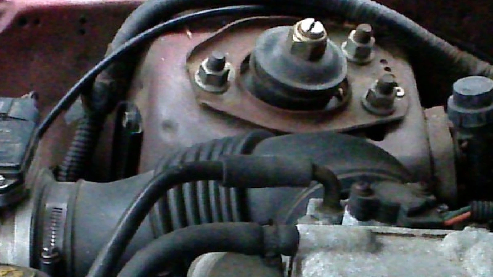

same time, once the springs/shocks etc are in the changed geometry would cause all sorts of unpleasant results, tires, balljoints etc... mine has camber as far over as it can. look at the photo and compare the adjustments to how your plate sits, notice the back pushed all the way over in the slots and last rivet hole, some guys will even grind more slot and drill a new rivet hole but unnecessary... also adjust tie rods... are you changing yourself? if so be careful of compressed springs... if not the shop will do adjustments when they install..

I will be doing the install myself. And I will make sure to be careful when I am doing the job. I will take a look tomorrow when I have some good light again to compare where mine is at versus yours.

By the way, because it was mentioned earlier in the thread to go and check about how my stock plates were sitting up there I went out and took some pictures today and wanted to see if anyone might be able to help explain what is going on. Thanks in advance.
