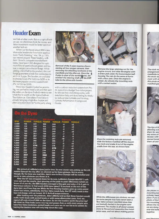

They will make some difference. Check this article out.

If you look at that post above at the track you would not notice much. they are nice on the dyno for a bit of peak but your average hp is not up that much.
If you go look at et's before and after shorties there is usually not much there.
Now the bassani mid length headers do produce power throgh the entire band on the dyno I have seen off them. the peak hp is not alot better but the average hp is up nicely.

I have the BBKs sitting on my floor now. 270 bucks. Thats a not so bad for 5rwhp and 11rwtq. Check out modular depots dynos of intake plenums. People spend 300-400 on plenum and TB all the time.
Those dyno numbers make no sense though. How can you make more torque at a certain rpm, and less power. Power is just a function of rpm and torque. :shrug:
