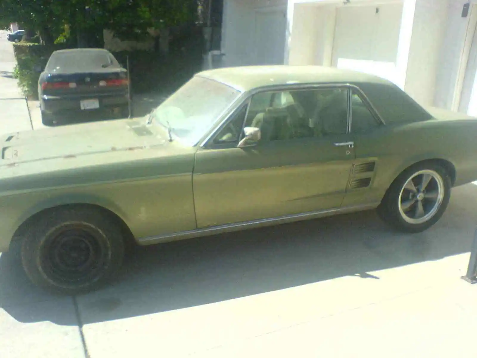

Not sure if I'll need to roll the front fenders, but the back seem to fit fine. I got the adapters on order so I'll update photo when I get them. Attached is a photo of wheels on back of car.
