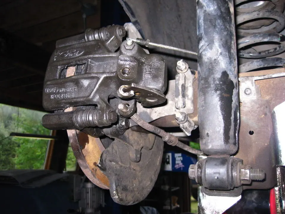

My buddy and I installed a 5-lug conversion kit on his fox today. I believe he told me that the rear calipers are off of a SN95 GT. I am pretty sure I have ran across this before somewhere but can't find it, will the stock length fox e-brake cable fit in that little bracket and work correctly, if not what mods must be done to fix it so it will?

Yes it will Mike, i have the fox E-brake cables and i outlined how to re-use them in the brake swap thread, however i do recommend switching to the sn-95 brake cables, with the fox cables you really have to yank on the handle to get them to hold, i dont care cause i rarely drive my car and leave it anywhere
I know this is old, but do you have any pics Shaolin? I'm running low on "mustang" money and I don't want to spend $75 on new cables.
And I do have an '87 and you said it wouldn't work in yours. What was the difference?
