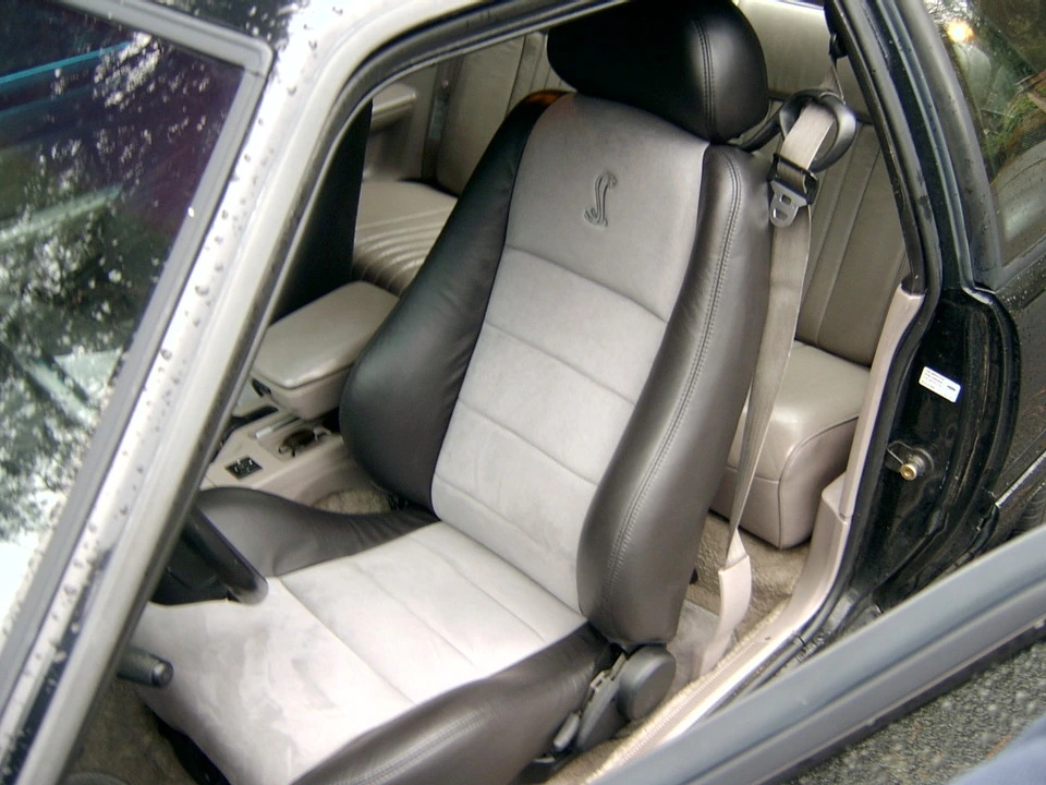

1 1992blkGT New Member Mar 28, 2003 523 0 0 Beaverton, OR Feb 26, 2004 #5 Feb 26, 2004 #5 I have 03 Cobra seats in mine. They sit a little higher than stock, so if you're tall don't get them. Attachments bothseats2.webp 120.7 KB · Views: 126
