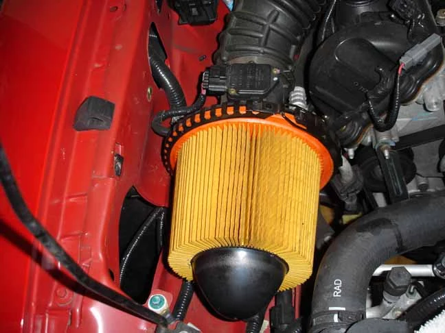

I was going to take out my K&N from my stock airbox to clean it, and put in the old stock filter in the mean time.. Then I said wait a minute, why not just put in the filter without that restrictive looking airbox. I rigged it in with the stock airbox clamp, and it holds in fine. Anyone ever done this? Is this a bad idea? Will the filter burn/catch fire or somthing?
See pic for the setup. I haven't driven like this yet, because I want to make sure its safe before I test it out.

Probably won't catch fire, but you'll lose probably 5-10 hp from sucking in all that hot air from the engine compartment. It's sort of like those "open element CAI" .. they're crap.

The open element is a bad idea as not only do you get hot air, dropping power, but you can get some fan wash (not as big a deal as it used to be on the 5.0's) which will cause the MAF to read incorrectly.

sucking hot under the hood air will cost you power. colder the air the more oxgen in that same volume of air. the oxgen is what the engine needs for combustion. so why does it not make sense too some of you guys that air over 180 degrees under the hood is not as good as 80 degree air.
You would have a faster car when you first start driving, but once the car gets hot it will drop a few HP....however at the track if you pull the head light you will gain some HP. i would try and cut the stock piece to where the front and more of the side closest to the fender is open, but the side facing the engine is still in place, acts as a heat shield. you can leave some of the top there so it will shield the intake from hot air more.

Went for a drive, and really got on it a few times.. I think the accleration is improved. My biggest concearn is the VERY hot radiator hose which is like a centimeter away from the filter.. if they make contact, it may burn the paper filter.
Not to worry, the heater hose won't get hot enough to burn the paper filter. If it did, the rubber would start to melt. :D
