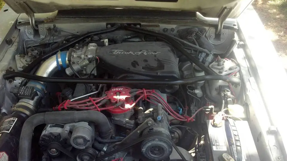

It sure should work for ya. Delayed response I know :) Mine has a 1" spacer and just barely didn't fit under my strut tower brace, fit fine after a little adjustment tho of course. O ya forgot to mention I do have a 2" cowl hood so can't be 1000% sure not running a stock one, but I can't imagine it not fitting with the 3/8" spacer if the 1" only makes it stick up this far. I also have energy suspension poly motor mounts, not positive they lower the engine any like the stock vert motor mounts altho I have heard they do, but I do know they wont raise your engine up any like a few other poly mounts will.
