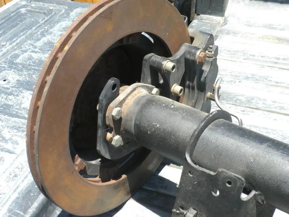

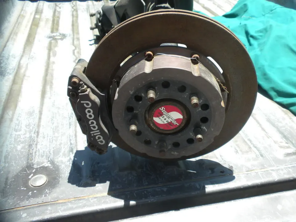

So I picked up this 8.8 axle, has 31 spline superior axles, wilwood disk brakes, and 4.10 gears and not sure about the posi/diff yet... From a 86 mustang I think but not sure on that. Anyways I am trying to figure out the parking brake set-up. It has nothing as far as e-brakes as I can see. Wilwood sells some ebrake kits, anybody know the right one? I can't seem to find the right fit yet??

Yea I know, I thought I put the pics in but here they are... The rear end turns up to have ford 3.55's and a Detroit truetrac locker... Cant find many part numbers...

I think that's the case. He'd would need to buy the entire drum assembly and use that as the calipers are not e-brake friendly
It looks like the rear has 8.8 ends still and c clip eliminators..
Give Wilwood a call their tech is good, never seen a spot caliper but I would assume it can mount anywhere with a custom bracket.
