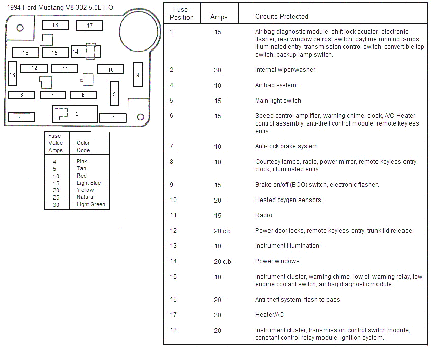

If all the electrical connectors seem to be seated firmly in their respective plugs, and none of the connections/wires are visibly worn, I suppose it could be possible that you accidentally shorted something during removal/install which could have blown a fuse. :shrug: You might want to check if the respective fuse is still good.
Also, if the master switch on the passenger side has one of those window-lock buttons on it, make sure that isn't engaged. :rolleyes: If neither of these tests yields a solution, you may want to begin checking if the motor is receiving proper voltage; this can be done with a multimeter. Here is the full checklist from The Haynes' manual:

As for my problem, its the driver side motor, so theres no window lock. I checked the fuse, its actually a circuit breaker and it powers both the passenger and drivers side windows. I rebuilt the passenger side too; plugged it back up and it worked fine. I even plugged the drivers side motor up to the passenger side and it worked there. so I'm thinking that my problem is either with the plug for the motor on the drivers side, or with the drivers side switch. the passenger side motor works from the switches on both sides of the car, so the problem may be with just the drivers side switch. its weird though, b/c the window worked before I took it apart, just not well b/c the bushings were bad. it seems strange that the switch would go out now.
