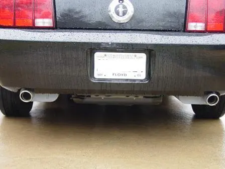

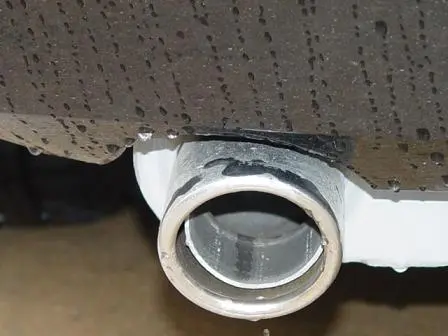

Personally speaking, I took a box knife and cut the stupid thing out using a cardboard template from the right side. Took about 5 minutes and looks perfect.

Nah, Flowmaster 40s. Love the sound though. They dont really come out any farther than the rear fascia does, picture may be a misleading a bit. I just had some old tips cut off and welded on the guy had lying around the shop.. they werent measured exact or anything to the dimensions of the car like JBAs might be.
