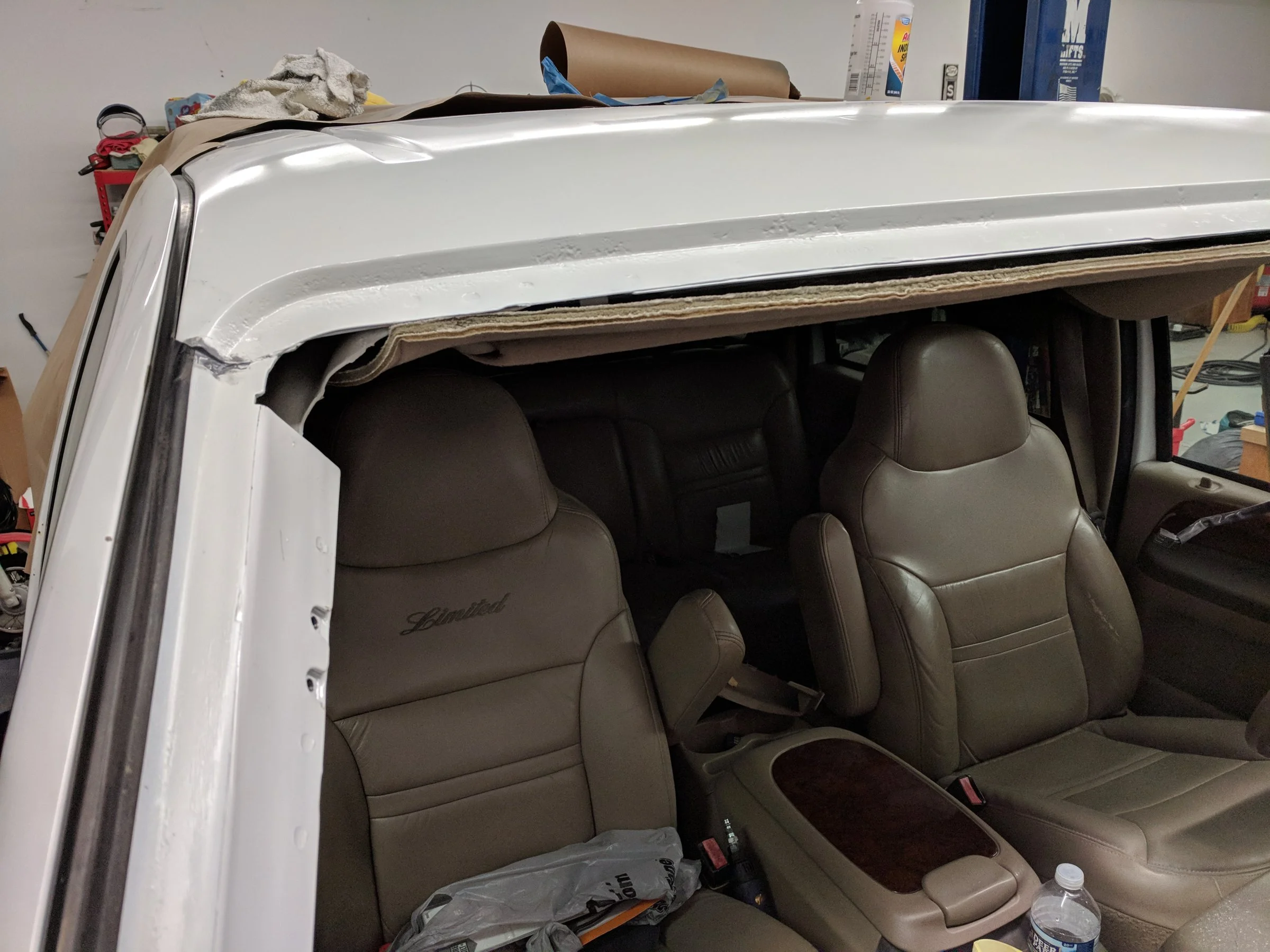

The windshield guy came to put a new windshield in my truck and we found that the previous install was pretty bad. There was rust around the edge of the windshield and was spreading. The windshield is out and I have gotten the frame to bare metal with a wire wheel. There rust was just surface with just a few spots that are starting to pit. But, I still have the black rust stains that I know can come right back. I think if I try to grind them completely away I might weaken the frame as they are in the corner.
I'm trying to get this done in a short amount of time. Is there a specific primer or product I spray before primer that would help keep the rust from coming back. Preferably something I can get pretty easily that's either rattle can or brush on.

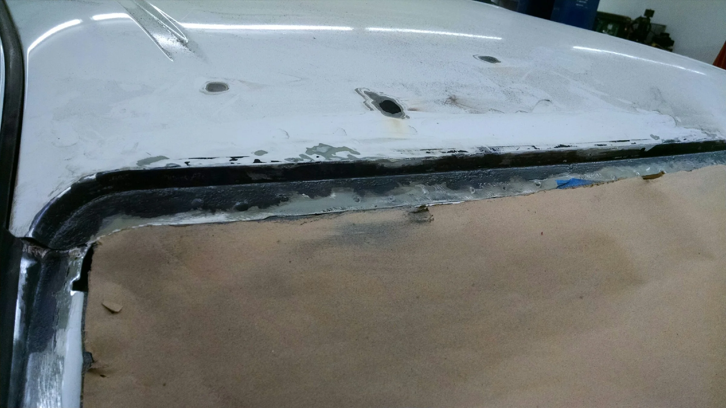

It turns the rust black, you can see all the little spots were the rust was. It was really rusty behind the hinges and that whole area turned black.
0oYP5wrSrUgQPMKiQxb1lHowPOLNDp1WVnIZvBNi1npLtxy4AqJdZ0rPVlgvn14ITSFKconAUCYjAL7yat9KmmZN2kYK4RSeFeeM8QALCLVcl7YYm5wT81_FYl9o3ZZ9BwkFsbtG8q0yyDza72QxRAYfzEwtIkcHbate26wLgtYEi4WT5-jENNwLnFGrrcdNEOF3-XEmy5f6hRmombxBQGFfYwW-rlWs2iNIljWWtW0FFS9FPoEbgNyCBjR8FjK3oPGRxFK1mCvf2D_VnLNeul3rSb4Srt4Eh65oMJa2epX__mLe8YkHdrNyB19bXX-I_PzTIa2ZdpkDscUcAo_6uJ8B5V4Zyfr97EG0IWSX8p2Lz_ubM_yIvNsQceyS_rdjJLYpz0dQl2v4KJJL_Y1dvJnyDkRi8M3uE3Hr0rj2zUrHR2xRpIDwcH-bdLi-PUIoK6MYNx5a1LVN-xMW_nLTJB8dSdL9Qm6l-xScrvgOx3fK0G23wFPLAPG7DHoNE5tp1oyZEuVt48evVCnC0o_HX6qYuurbFAU8fksWt3rcn8JQ1Pg58ybzYxc6flQWFpzhtTAupv3yXT7FrnvAi3E7Gv6mupJIIG0zcKnJNcXNKA=w1687-h1265-no
Phosphoric acid solution. It's what we used at Safelite to get rid of as much rust as possible. We also used specific primers that wouldn't affect the bonding of polyurethane window adhesive. The primers were made by Dow or Sika, I don't remember which ones anymore. Do not use body filler in the pinchweld areas where the glass sits.

I wish I knew of a place to grab ospho last night. I got a similar phosphoric acid based rust converter from the local auto parts place(I think made by loctite) last night and brushed it onto the rusty areas. Hopefully it works similarly enough and stops the spread. All the rust did turn dark black.
My current plan is to use an etching primer next since I have some bare metal, then sealing primer, then some duplicolor Oxford White and maybe some clear. If all goes well, I will be ready for a windshield on Monday. It will be nice to get that back on the road.

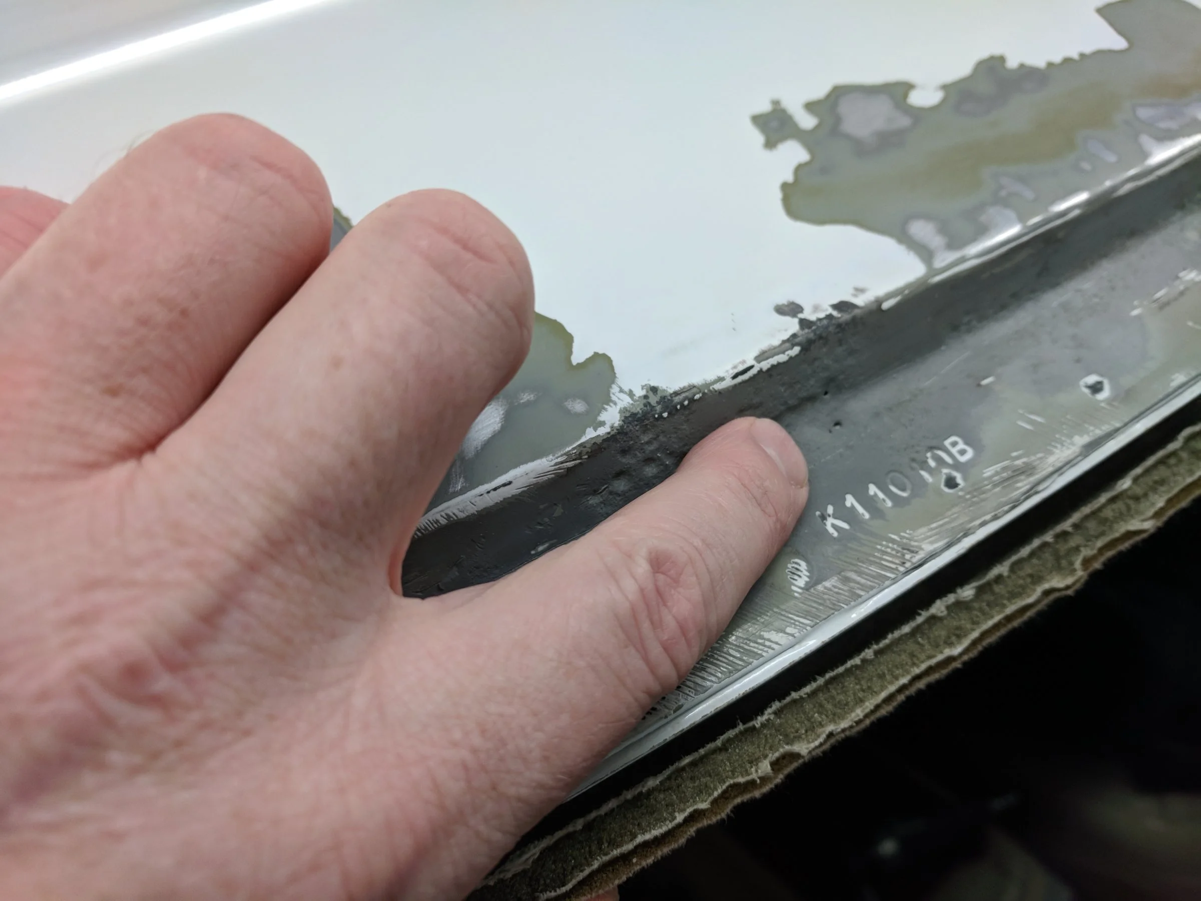

@Davedacarpainter This is the worst area. It's a little hard to tell from the pic because it's already been "rust converted". I had hit it with a wire wheel and smoothed it out. It was still brown at this area, but most of it was black staining with no pitting.

I don't see that it's rotted:nice:.
The rust converter will only go so deep into you rust before it dries and the chemicals loose their ability to convert the rust. You will want to sand it all down and reapply the converter to those areas that are still rusted.
On the bare metal you'll want to use an etch primer or an epoxy primer. Though i wouldn't use an epoxy in this situation since the converter uses an acid to convert the rust. Acid and epoxies don't go together.
Have you thought of using a small hand held sandblaster to finish cleaning out the rust?

Blasted the frame. It came out pretty good except this one spot. @Davedacarpainter, what should I do about these? Can I just fill them, or do I need to break out a welder?
The problem there are the tiny little holes that go all the way through the metal (I would say penetrate, but, you know, the guys here:nonono:).
It means the rust will be on the backside as well. Plus the metal will probably be too thin there because of the rust.
You would probably blow holes through it if the welds would stick at all.
It’s not too tough to fix, just a little cutting, fabrication of a new strip of metal, etc.
Yeah, I was worried about welding that. Especially with the welding skill level I have available to me. I don't think I'll quite be able/have time to fabricate a replacement part, but I'll paint some rust converter on the underside and fill the holes with something. JB Weld?
Use an encapsulator for the backside. If you need to drill out one of the rusted through holes a bit to stick a painting wand in to coat it, that’s what I would do if i wasn’t going to cut the rot out.
Any heavy duty epoxy to fill the holes like jb weld or a panel bonding adhesive.
It won’t fix it for ever, but probably good for ten years though.
I just want to stress the importance of coating the back side with something that’ll seal it up, like POR15 or some such product.
Have you pulled the headliner away from the roof there to take a look at the backside?
I looked at the backside today. Problem is, there's another layer of metal under the parts with the holes. I filled it with the JB weld steelstick. I created a 2" long section to try and make sure it stays intact. I can tell my welcome is wearing thin at my buddy's garage, so gotta get it done.
