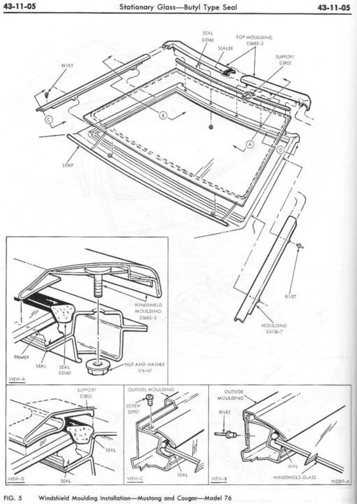

OK, that makes sense, however that seal is a secondary seal. Hang on, and I'll scan the shop manual page...
Does this look right?

So, are your side mouldings pop-riveted on like it shows in "View B" and the main picture?
I also see a drawing error - "View C" section in the main drawing shows a screw with an arrow pointing to it stating: "RIVET".
I don't know about verts, but this is one of those - highly prone to rust areas - on all the other 71-73s (especially if you already have water leaking through the main butyl seal).
