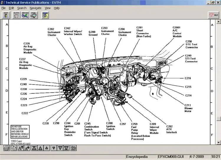

browell_66 New Member Mar 31, 2009 14 0 0 South Ga Apr 6, 2009 #3 Apr 6, 2009 #3 where is the interval govenor located?
browell_66 New Member Mar 31, 2009 14 0 0 South Ga Apr 7, 2009 #4 Apr 7, 2009 #4 anybody know where the wiper govenor is located? Under the dash/under the cowl?
jrichker StangNet's favorite TOOL In Remembrance. Thank you for your contributions Mar 10, 2000 27,512 2,813 234 Dublin GA Apr 7, 2009 #5 Apr 7, 2009 #5 Under the dash... Under dash component locations typical 93 Mustang. Others should be similar except for location of warning chime. Attachments Under Dash wiring & component locations typical 93 Mustang.webp 51.4 KB · Views: 150
