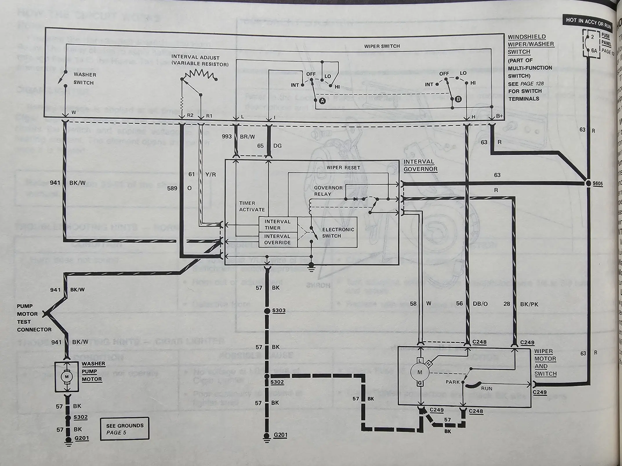

This is helpful I'd like to know what voltages to expect at the wiper motor if anyone has any of that information? I could just throw a new wiper motor on there but it seems unlikely to me if I can jumper them and they spin.
