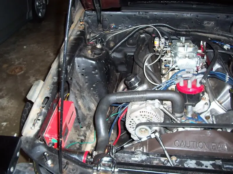

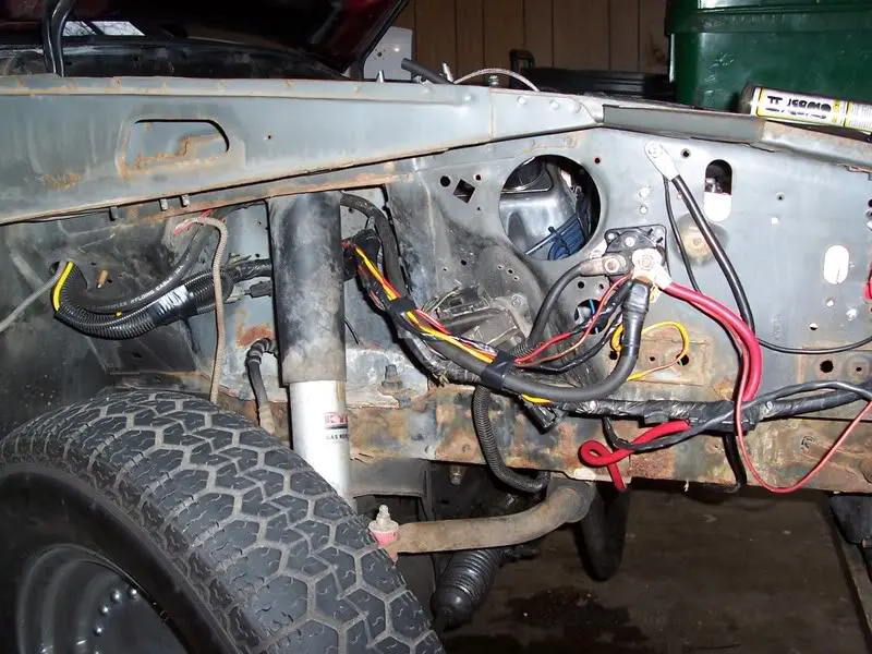

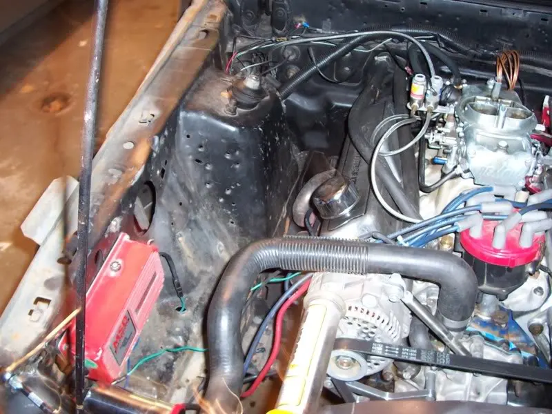

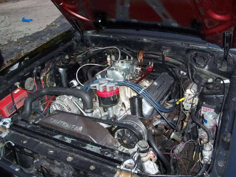

started in on it today. i still have lots to do tho. the only thing i couldnt fit thru the hole in the back of the passenger side was the front bumper light, it uses one of those push and twist bulbs. i just cut it and reconnected it.
anyway, heres some pics. if anybody has some tips for the big harness thing behind the motor lets hear em. the fuel pump is getting moved to the back and my fuel pressure guage (copper tubing) is going where the wiper motor used to be.
before (hideous)
and now

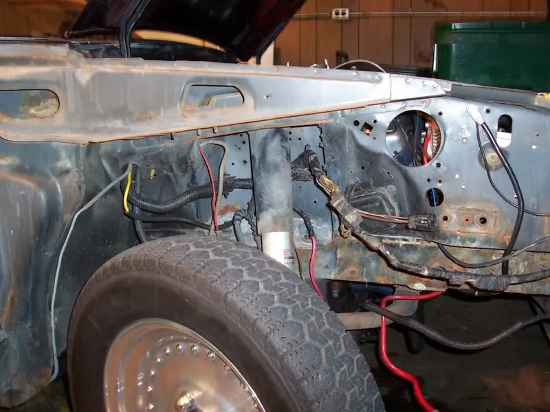

passenger side is done, and the car still runs!! haha.

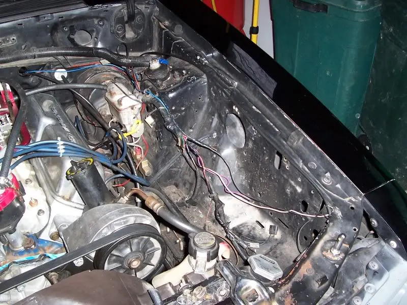

i took my fuel pump and regualtor off, and started making a mount for the fuel pressure guage. but heres what i have to work with on the driver side.
Aren't you gonna be pissed when you get everything together and your coil takes a dump on ya? I wanna hide wires but i also want anything that may need replacing to be easily accessible.
ya, im hoping it works for a while. even if it does crap out, all id have to do to change it is take the inner fenderwell out. right now i took the fender off just to make it easier. i probably wont take the driver side fender off, just the inner fender well.
passenger side is done, fender is on and everything. i got it all back together and there was a gap between my fender and the bumper cover, turns out the stud all the way at the top screwed its way out of the bumper. i had to take everything back apart just to screw it back in. :nonono:
