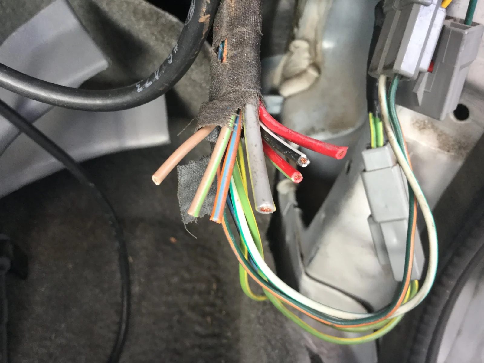

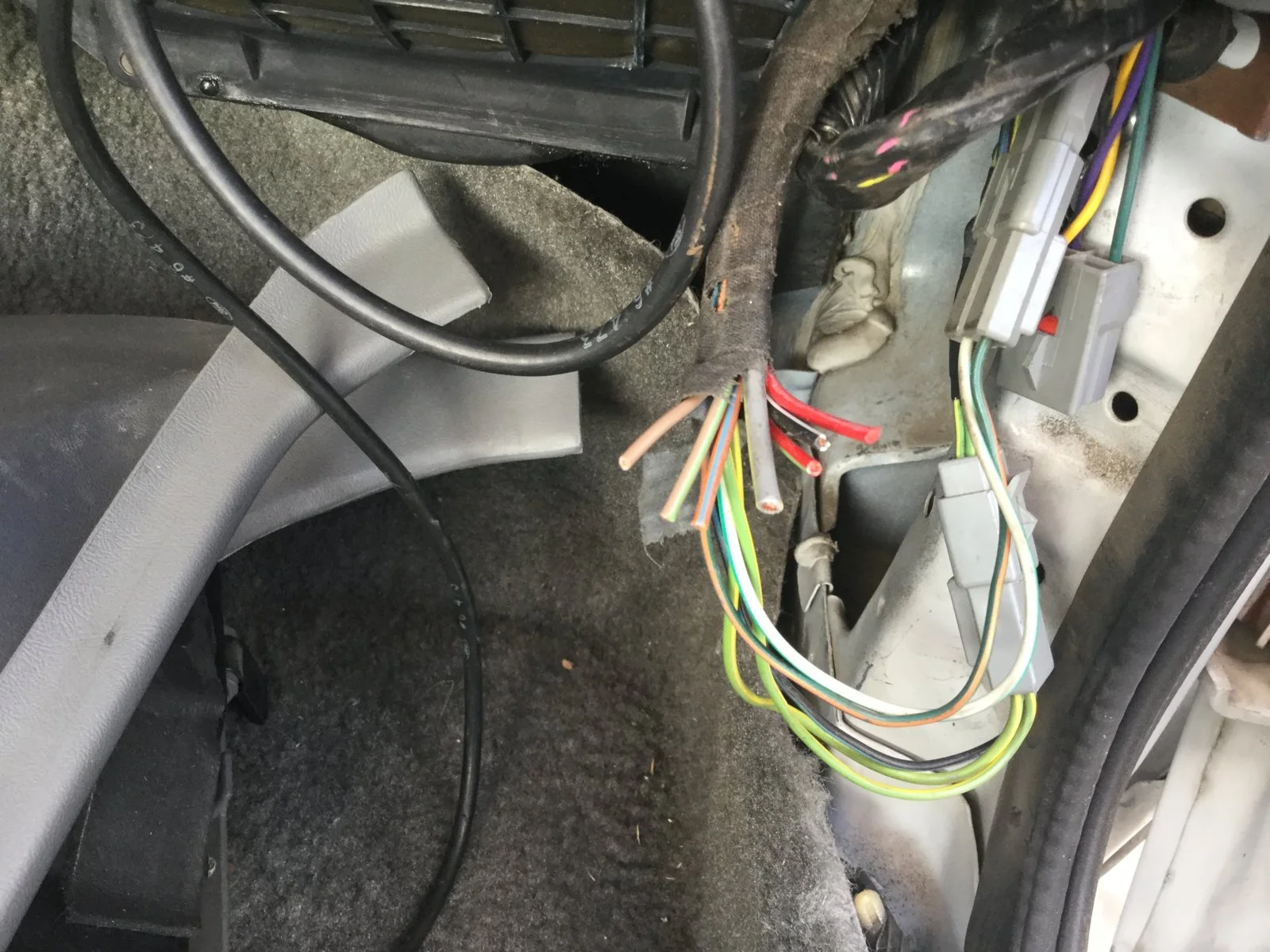

The PO of my ‘89 GT went a little crazy with wire cutters. On the passenger side kick panel he cut some wires and unplugged a group going into the rocker. Anyone have a picture of this area? I have a Ford wiring book by can’t make heads or tails of it. I have the colors written down so if anyone has a picture it would help. I would post a picture if I could figure it out.

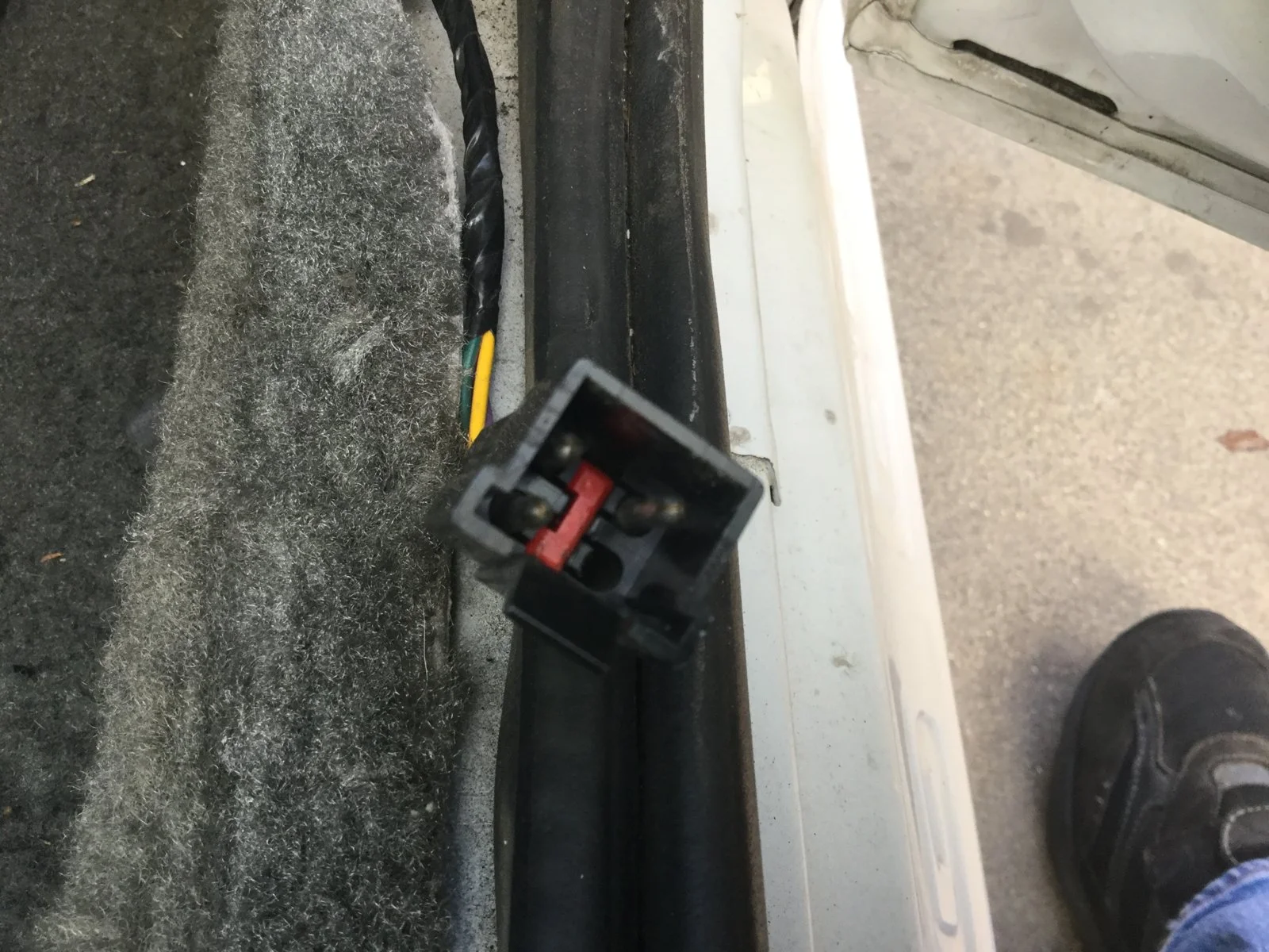

Also show an extra picture of the mating face side of the connector so that we can see the connector shape and how many pins are in the connector. That helps identify the circuit function since most of the connector shapes are unique to the circuit they serve.
That LOOKS like the C213 connector that got cut out. Do you have a green connector anywhere near the ECU? It should be part of the main harness. Also - Does it start? Because some of the C213 wires are for the fuel pump.
This is a ex race car. So that being said the PO took everything from the radiator to the rear axle. I got the perfect body with just the front suspension and steering. He cut a lot of the wiring out. This is part of it. No fuel tank or pump. No ecu or wiring for it in the car, but I do have it to install. So while I’m building an engine and gathering the rest of the parts to put it back on the street I thought I would try to sort out the wiring. I do have a ‘90 GT convertible parts car. But right now it’s at a different location so it’s hard to see if it has the plug I’m missing.
wow what an ahole... If it were me I would pull that main harness out and buy a good used 89 main harness to swap in it's place along with the ecu. If you plan on using the 90 wiring then you'll have to repin it all or swap the dash harness out for the 90 wiring as well.
Unless you're looking to have it be exactly O.E. or it's not in your budget. I would look into something like this: https://lmr.com/item/AAW-510547/Mustang-American-Autowire-Classic-Update-Wiring-Kit-87-89
Not a lot of good reasons to use a 30 year old harness that may or may not be properly wired in any particular spot.
