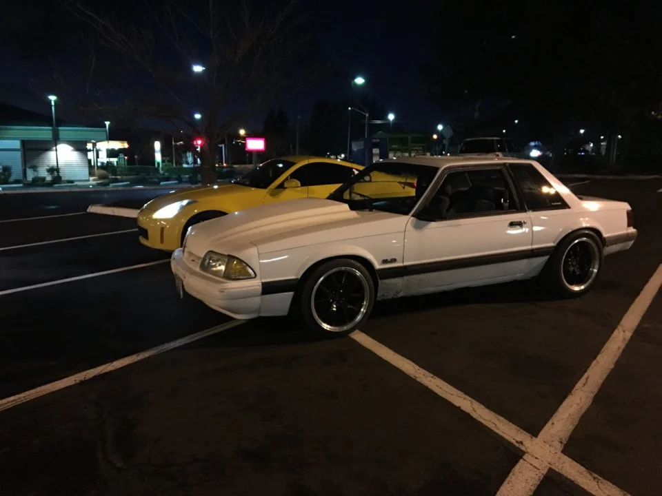

I recently got a 89lx notchback factory 5.0
the car runs great,but has its issues(gas and temp gauges don't work) besides that, around 3500 rpm it cuts out and wont go past 3500. I pulled the koeo codes, and 23, and 66 came up. koer 23 came up.
I attempted to adjust the tps, it was reading like .2,.3 closed throttle, and got it to 1.0 1.1 volts. But that didnt seem to help. I havent checked the codes after adjusting the tps
thank you guys
