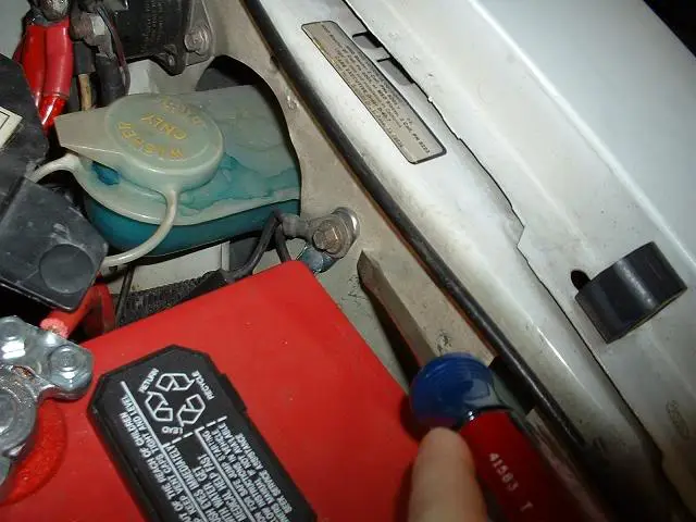

The large negative cable bolts to the block down by the oil filter.
The small 10 gauge wire bolts to the body up near the winfdhield washer filler cap.
