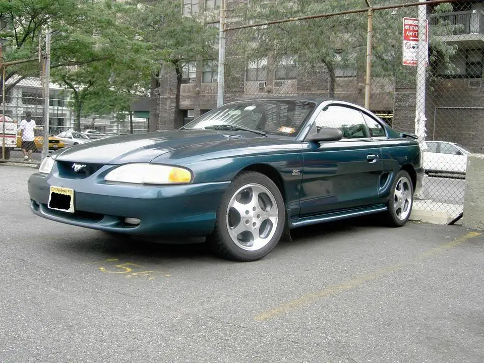

My first stangnet pics!!!!!!!!Clear cornerlites soon to be installed
