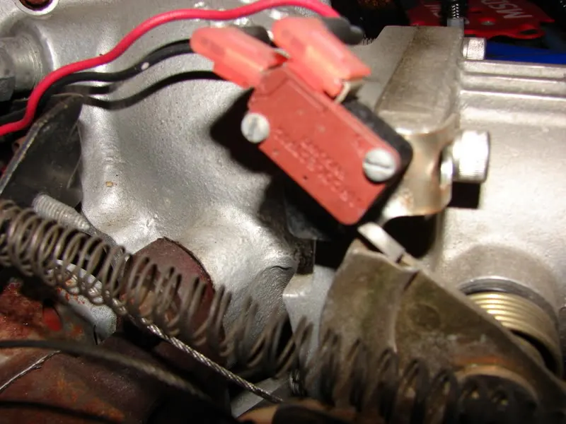

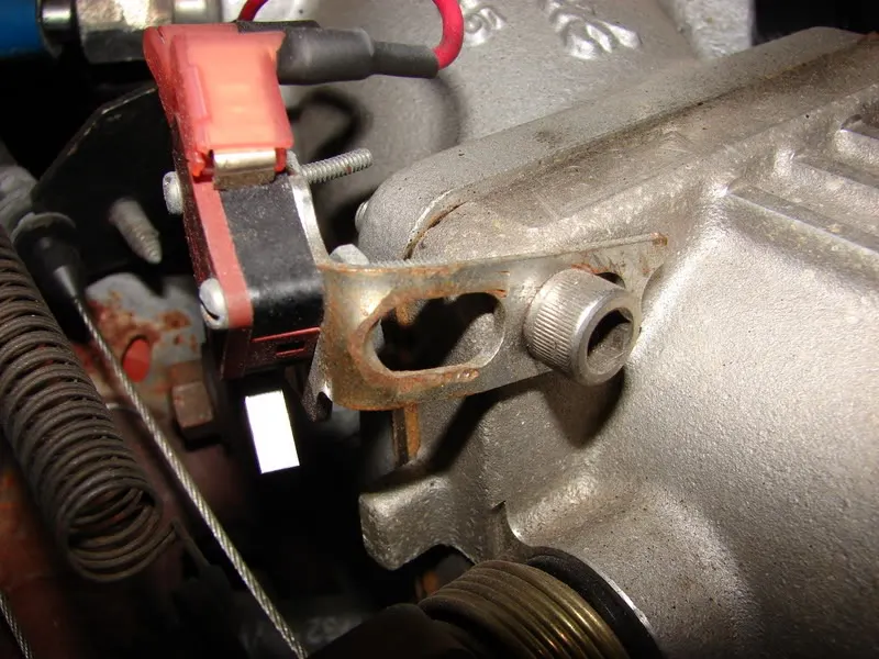

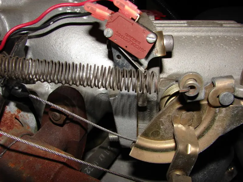

With my compucar kit I just have a bent L shape bracket (think the bracket came with the kit). I mounted the bracket to one on of the t-body mounting bolts that mounts the t-body to the upper intake (or elbow). I had to put a slight bend in the arm part but it gets hit by the throt cable armiture(sp?) that gets pulled by the throt. cable. When its at WOT there is a big end that has a groove in it that is what hits the switch. Go under you car and pull/move that part and you will see what I mean.

Allthrottle, here are the pics that I said I would post for you, this is how I currently have my setup with the big shot plate kit.
Hope these help you some.
