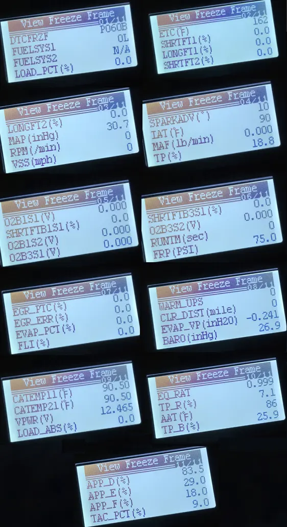

I have a simple scanner and could not get more details. Freeze frame is attached, if that helps.
