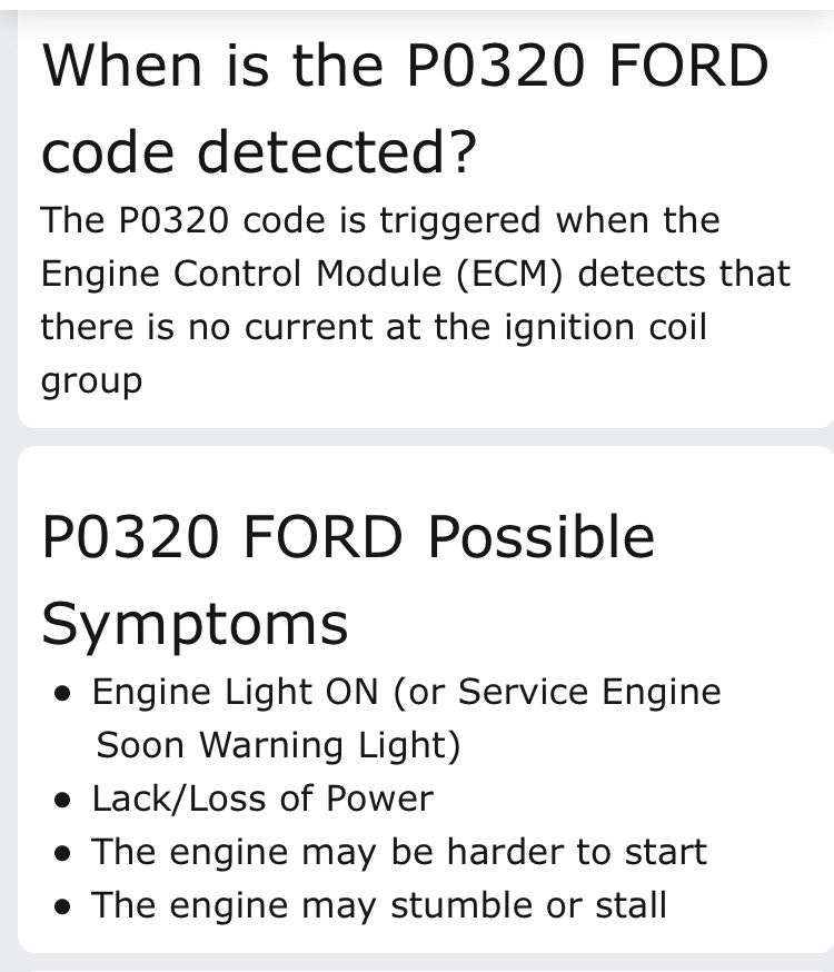

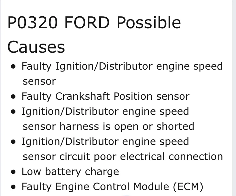

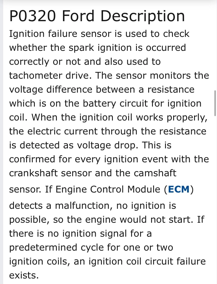

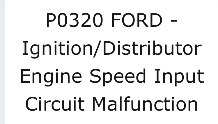

Only code is p320. Put a new crank sensor on and still the same thing.

I got it fixed last night. It was the crank sensor and the throttle. The crank sensor wasn’t letting the throttle body come up on the scanner, but once I put the sensor on and my buddy came back over it then showed the throttle body. So I drove it today for about 40 minutes so all is good. Just glad it wasn’t in the wiring. Thanks for the help guys.
