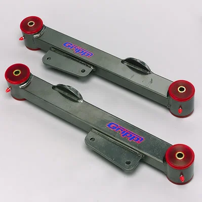

These are $189.95 from summit.

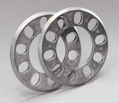

It will probably still touch. If you dont want to remove the quad shock, you can run a small spacer like this,
They're around $12 from summit. If you go with 1/4" or less, you shouldn't need longer studs.
