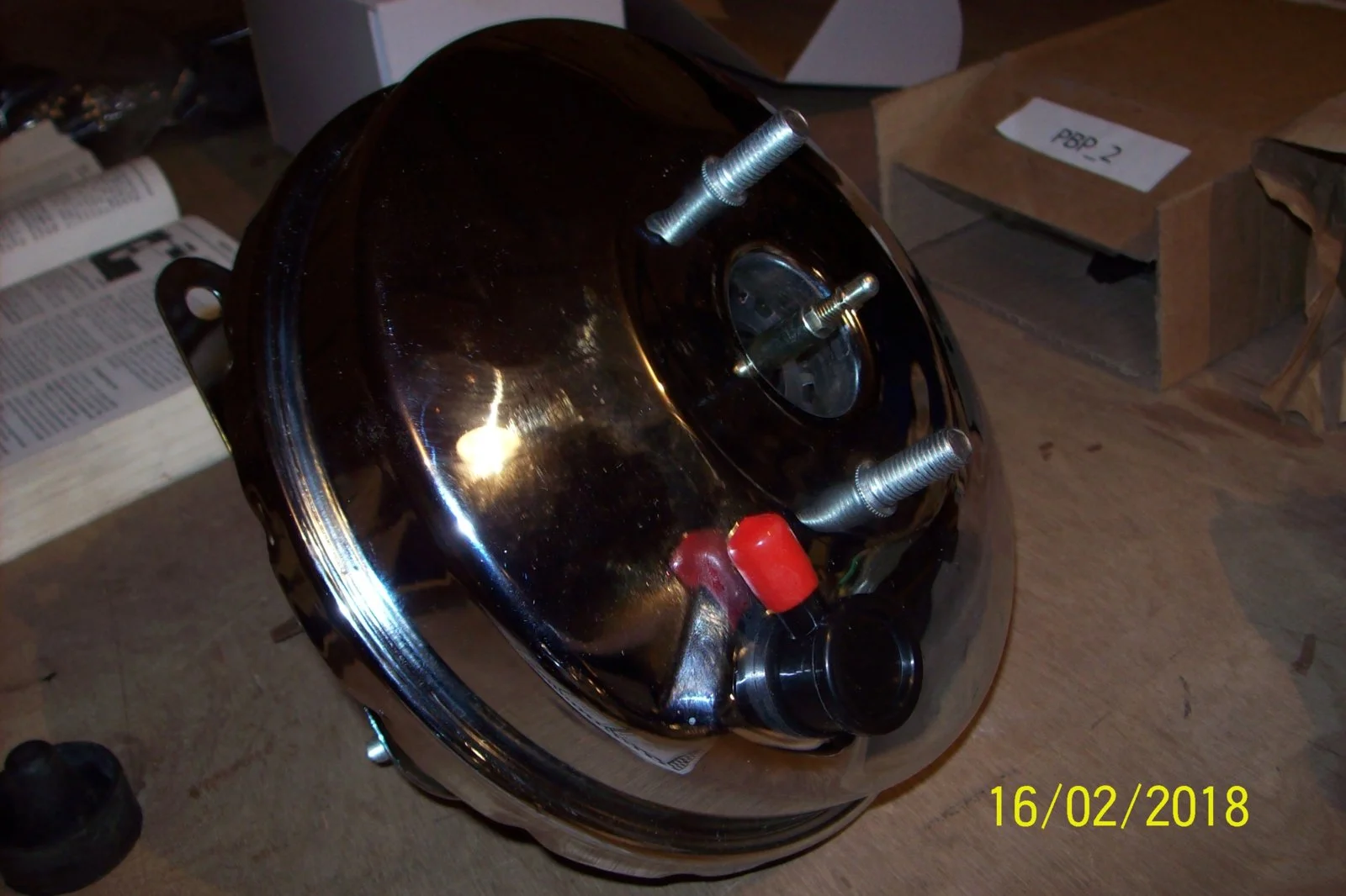

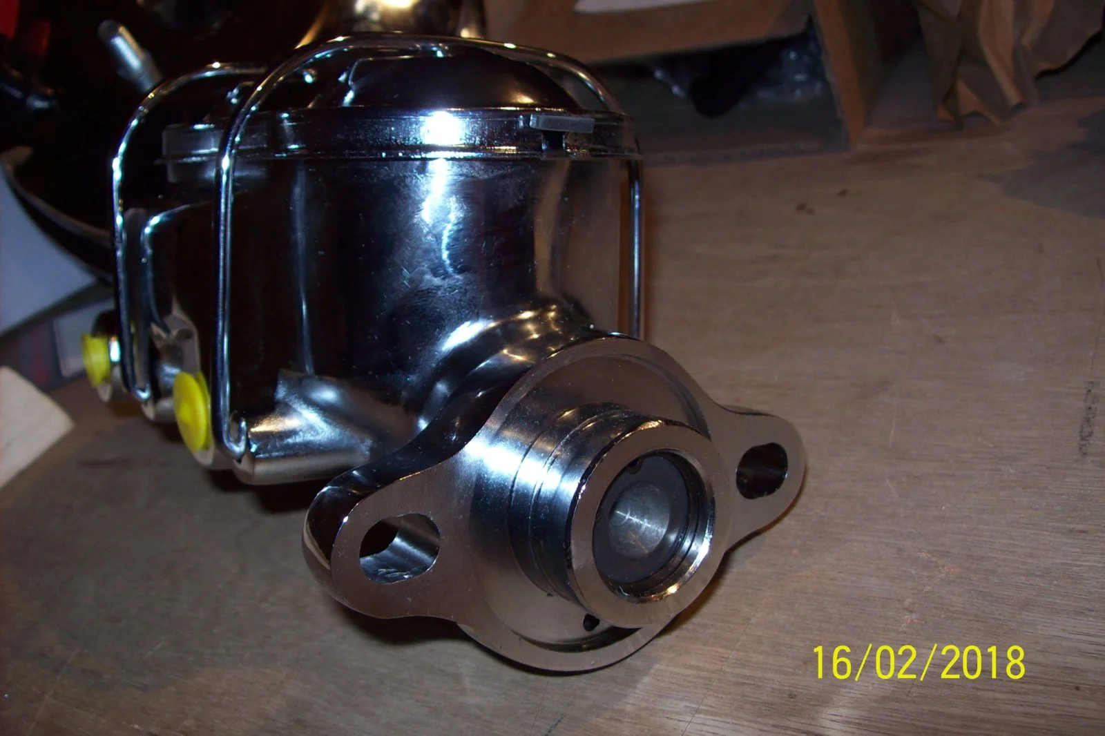

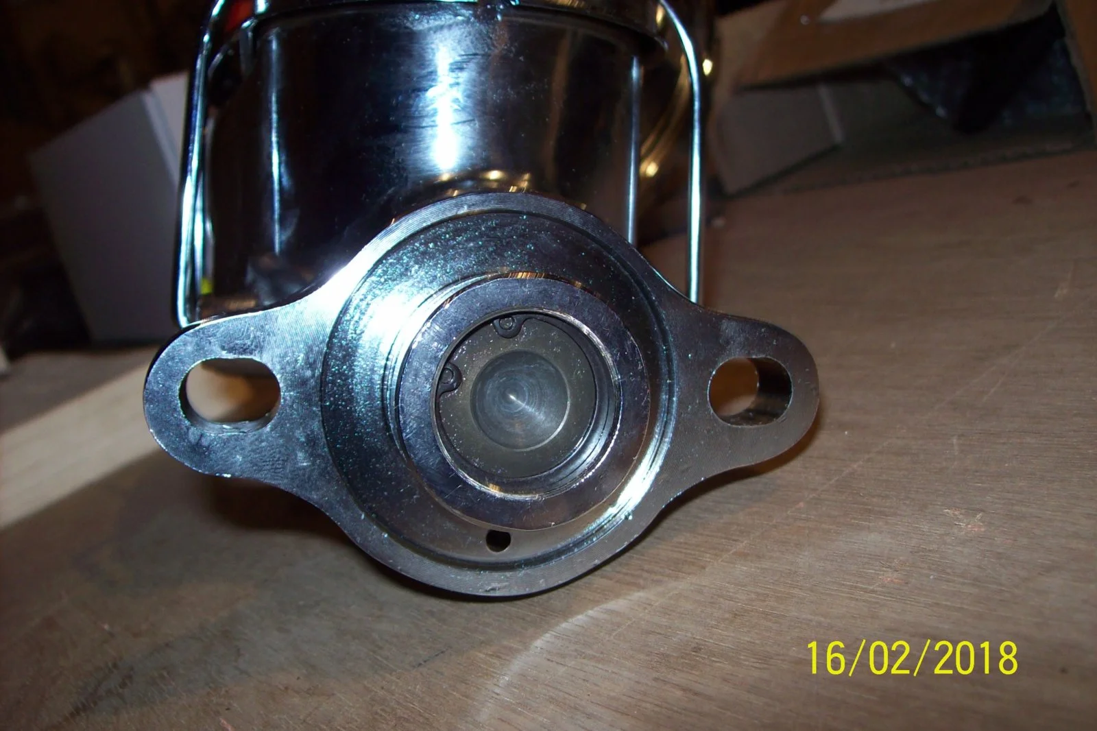

Received in the mail a 9" Ford style single diapham brake booster, and a corvette style universal master cylinder. The ad from the supplier says direct bolt in, the problem is the booster plunger protrudes out approx. .950" [it is adjustable somewhat] and the master cylinder plunger has a countersink end that is close to flush with the stop point of plunger, not like a Ford with a .485" x 1.5" deep hole in the plunger. Called these people, they say these are the right parts. I Don't think so????
Hey bud, welcome to the forum. Can you give us a little more info on the parts? Do you have a link to the place you got them from? If you could post pics that would be helpful.
Sorry to have taken so long to reply, we have been away for the month of March. Perhaps the pictures will explain the problem better. The plunger on the booster hits the ram on the master cylinder before the two can be bolted together. A usual Ford master cylinder has a drilled hole in the master cylinder ram. The parts were purchased from Gearhead Enterprises in Iowa. I purchased a Ford master cylinder, it bolted right on like it should. Thanks for your help. Jack

You should probably email their support and send them a link to this thread so they can look at the pics and check it out. If you screwed the adjuster all the way in and it still won't bolt on, it sounds like they sent you the wrong stuff.
