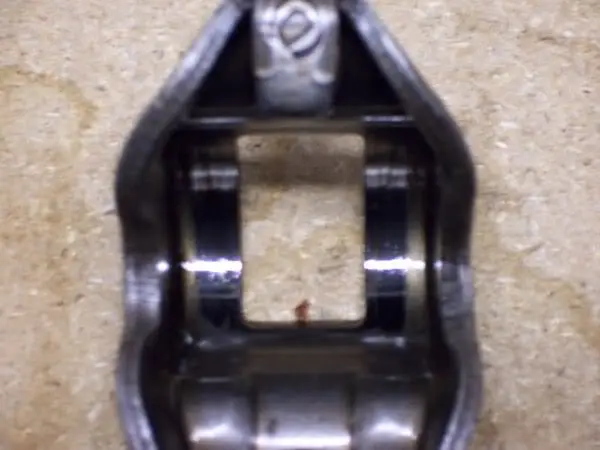

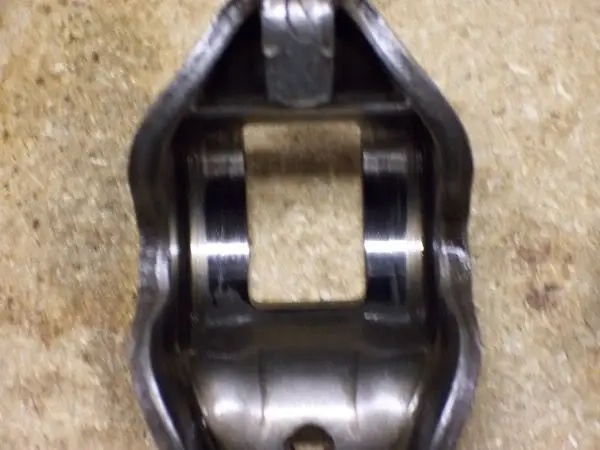

so recently i bent a push rod.........aparently i have a fat oil leak on the oil pan that i didn't know about. but im not getting any compression on number 5 the same cylinder the push rod bent, and that rocker are has really bad scaring on it.
so im guessing the valve bent, what would you say? or i have a hole in the piston.

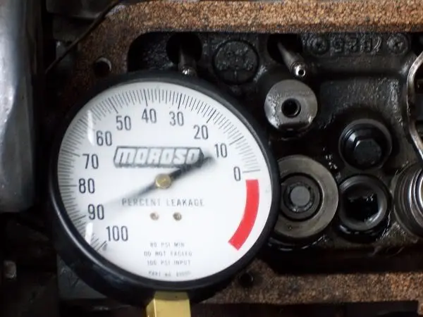

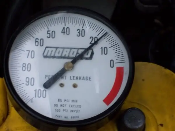

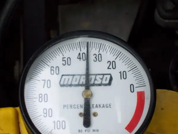

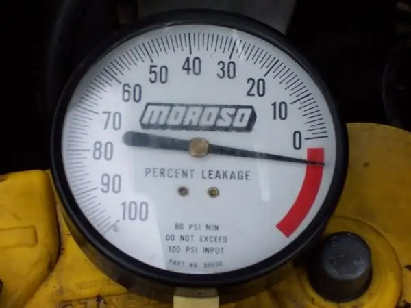

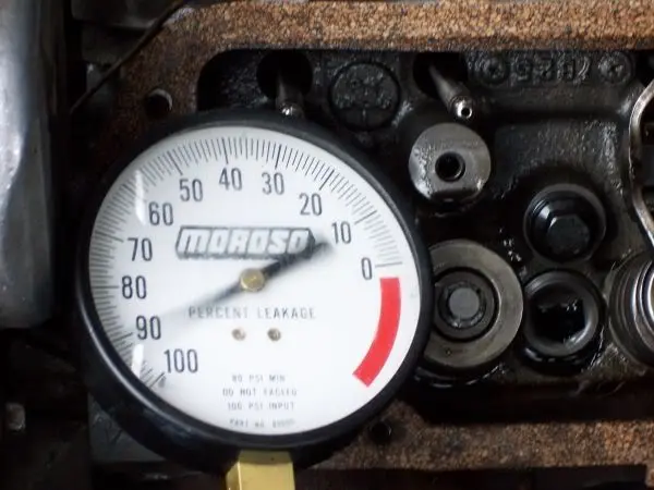

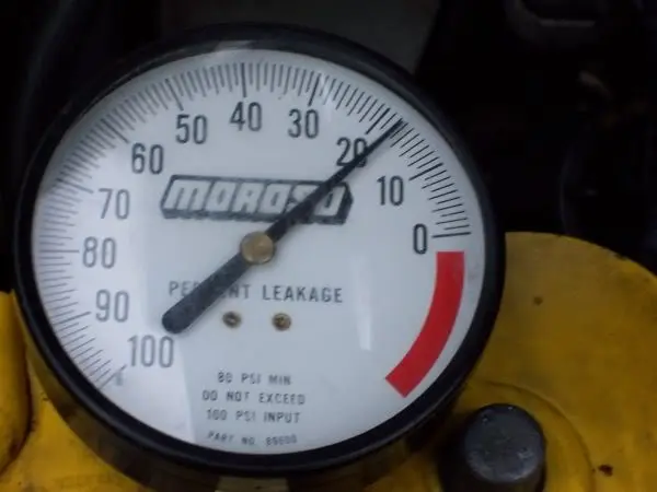

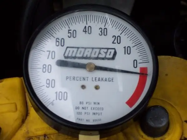

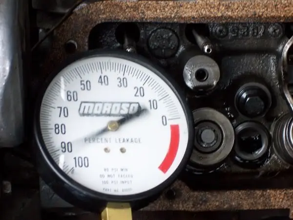

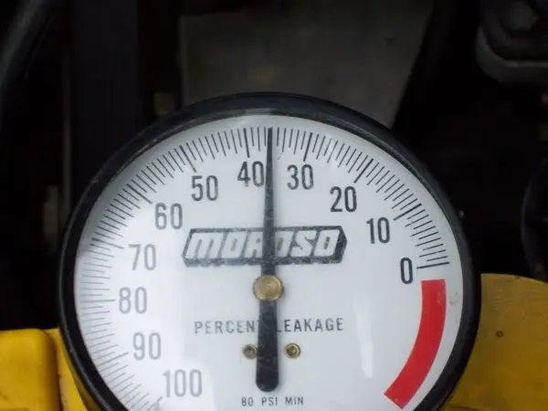

k did a leak down test,
cyl 5 80psi
cyl 6 80psi
cyl 7 80psi
cyl 7 100psi

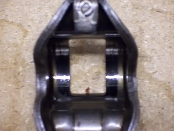

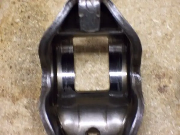

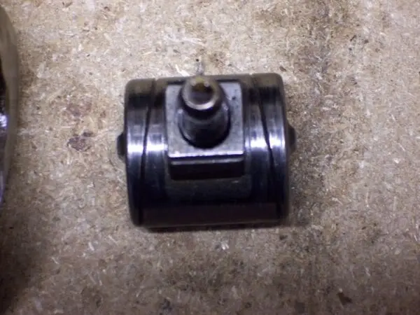

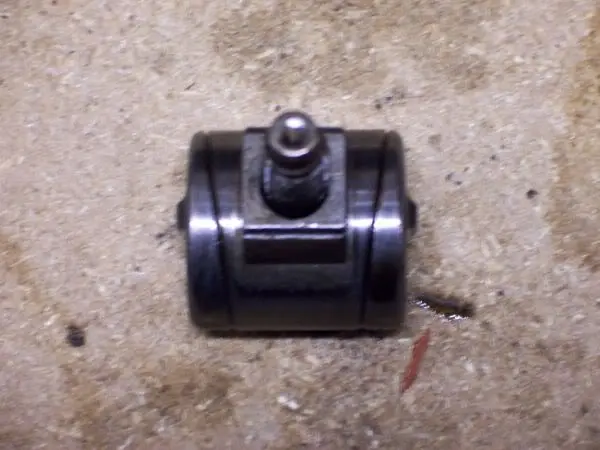

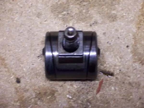

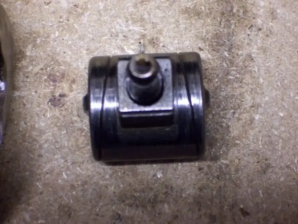

now the raocker arms have bad wear or scaring

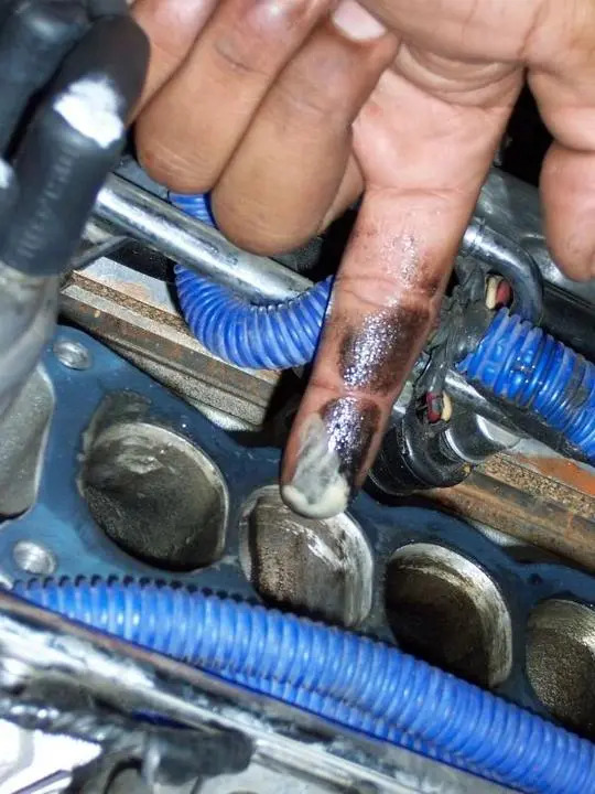

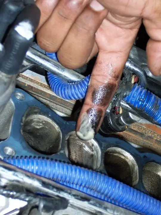

and milky oil is going to cyl 5 through the intake its also in the pcv valve
what would you guys say
