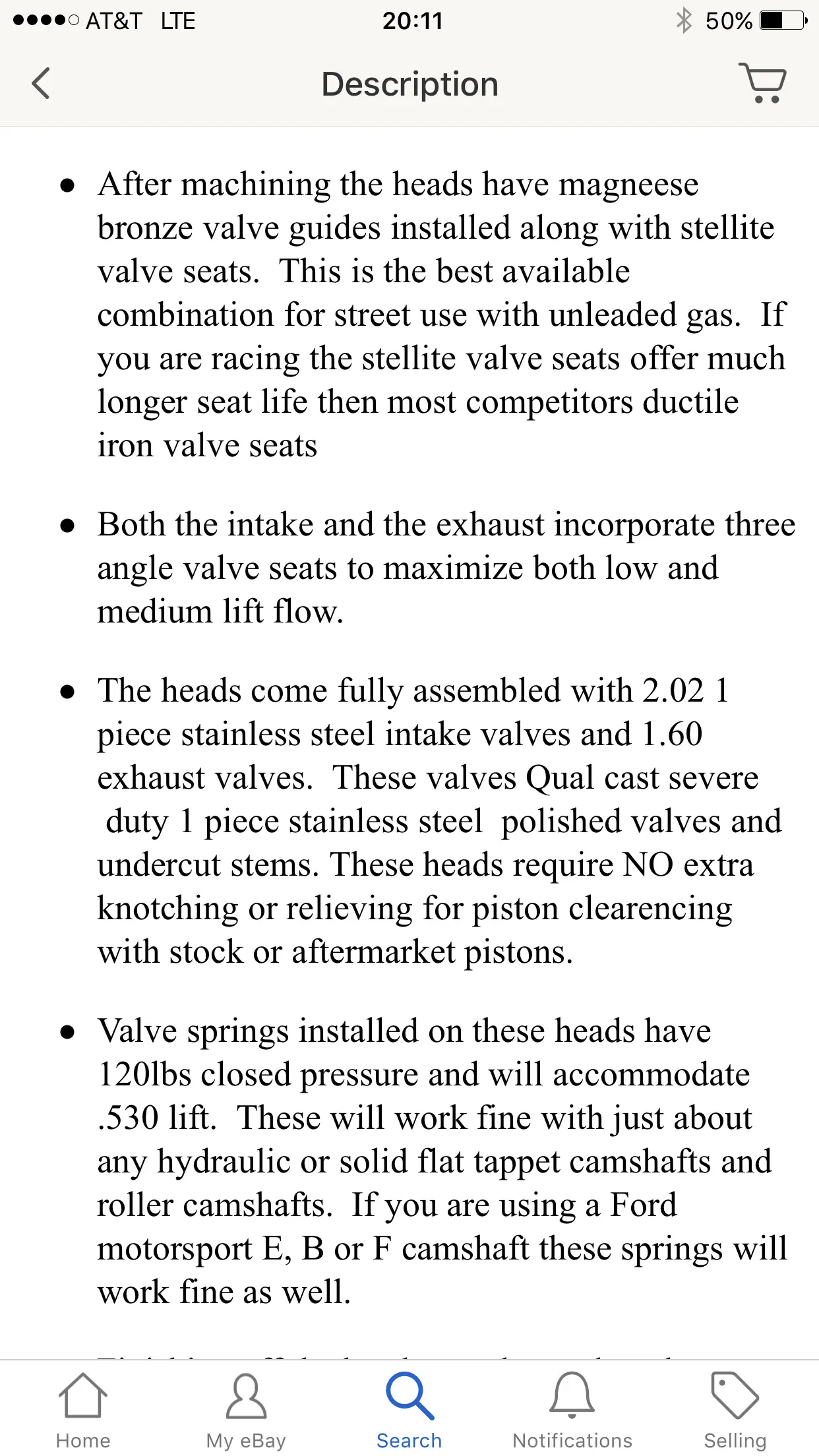

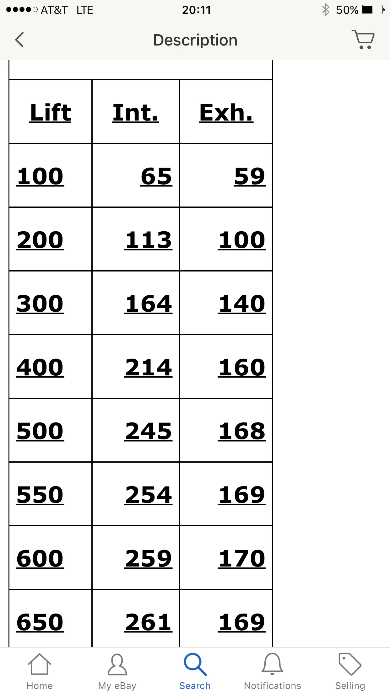

So I’ve got a 91 Coupe I’m about to build the top end. I’ve got a Ford Performance X-Cam, Rocker Studs, BBK High Flow Fuel Rails, 24 LBS Injectors, BBK MAF, 70 MM TB, Non EGR GT40 Intake, Built Aluminum Heads. Just going to see if anyone is around the same setup? Valve Clearance issues with the X-Cam setup and stock pistons?

Always check PTV clearance when installing aftermarket heads and cam!! There is no need for the high flow fuel rails at your HP, stock rails work perfect and at least you can rest assured that the stock rail will not leak and cause fire.
