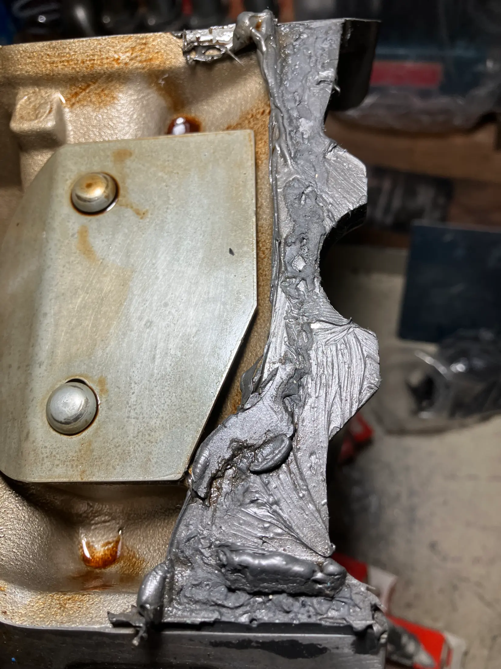

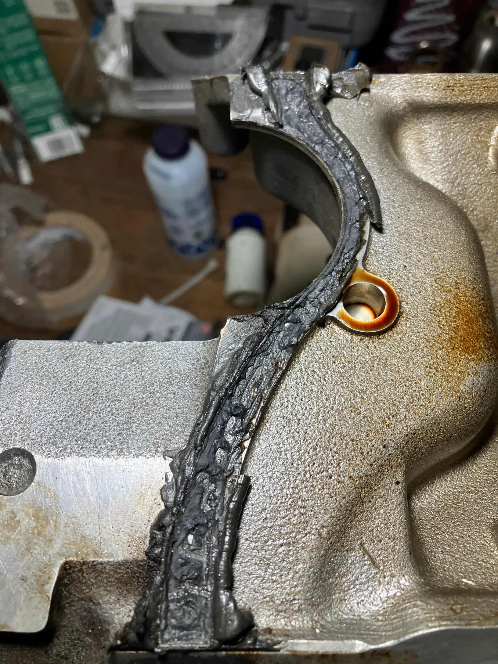

Ok guys I think I’m getting somewhere with these new findings.
So I removed the top end and found some interesting stuff.
Because my lower intake is held down by ARP studs it was a bit hard to get it loose from the back so had to remove all the studs but still I broke the seal and found some weird conditions.
Talking about massive vacuum leak??? Possible! The lower intake front end mating surface to the block you can see clearly the silicon beed broken as I lifted the intake so that means it was completely sealed. The rear part of the intake does not show that, instead they look like flat patches of contact against the block but it doesn’t look like a constant beed of contact. That opens the door for a major vacuum leak, but the stunning thing is that I sprayed carb cleaner and even I use propane back there and no hesitation or change in idle speed.
Please see the photos of the front and rear intake/block mating surface and tell me your opinion.
On the rear you can see the smears of silicon as I was spreading it with my finger.
Does it look like a potential massive vacuum leak to you???

I see good silicone squeeze on either the top or bottom side pretty much everywhere. I don't suspect it of leaking. I don't see any silicone on the lower-to-head gaskets, which I normally like to do, but the Felpro 1250s are usually fine. Nothing obvious here, to me.
Reactions: General karthief and PonyGTrider
The front looks there was a good bonding but I’m a bit suspicious of the rear.
I don’t know about you guys but just hate the cork gaskets and usually I toss them but this time I might use them with ultra-black RTV.
Also I had a couple of bad experiences of disintegration by the water port using the regular 1250’s, instead I love the 1250S-5 as they come out intact upon disassembly.
