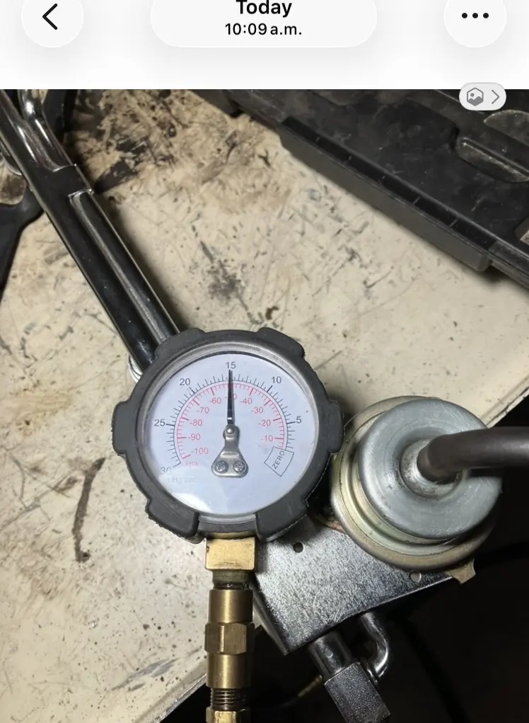

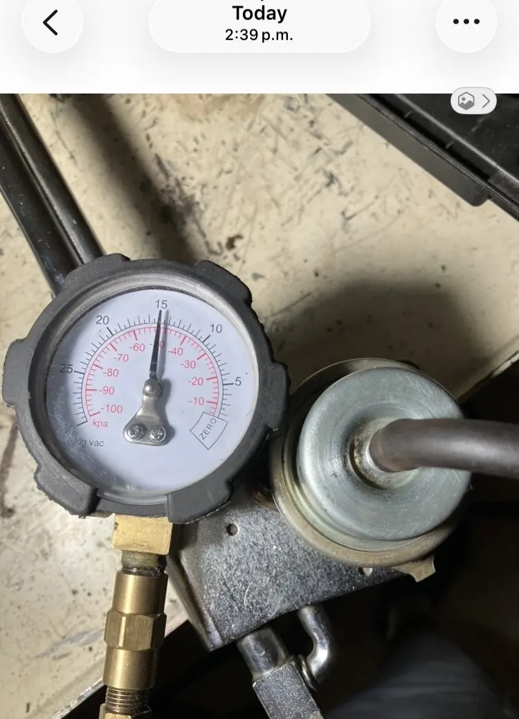

Here an update on one variable taking out of the equation.
Verification of fuel pressure regulator integrity.
I set the vacuum to 15 inches. @ 10:09 and after 4.5 hours @ 2:39 the vacuum remains at 15 inches.
Reactions: General karthief and AeroCoupe
